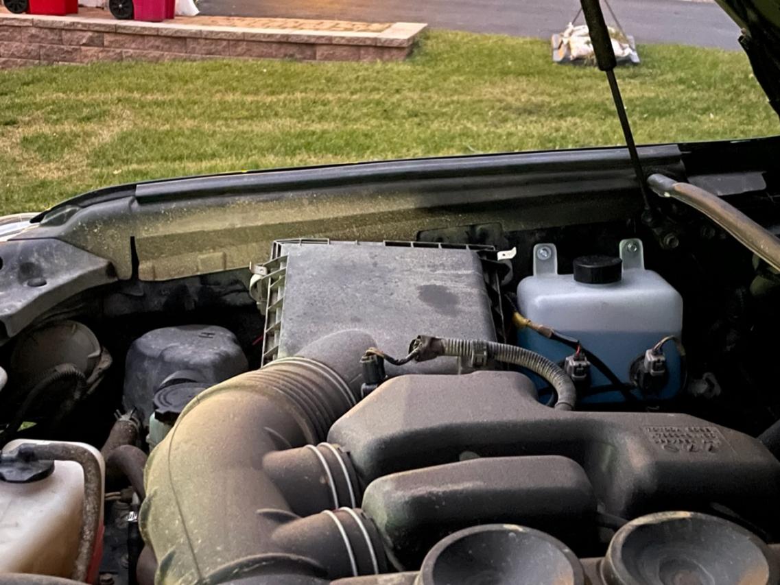

Thanks. May have just found a relevant picture. I like seeing the springs on both sides. I may do a washer tank relocation project next week :).

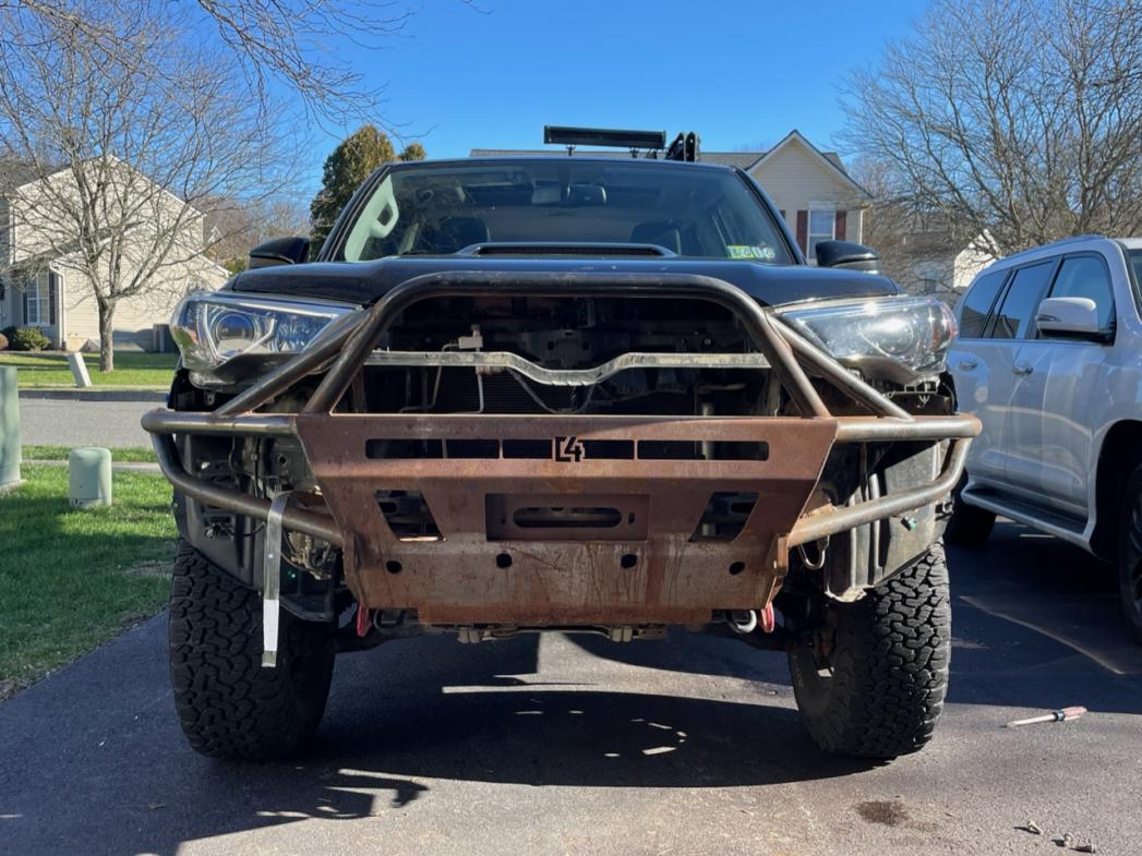

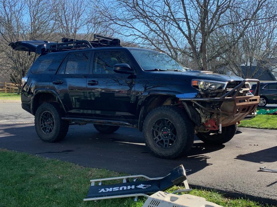

Got it on for test fit but my apex overland recovery points didn’t let me seat the flange all the way. Didn’t want to remove them because I was going offroad the next day. Little bit of risk that something could be off since I couldnt get it bolted completely up tight but probably not. Taking it to powder shop this week.

Ended up moving the washer tank. Happy with how it turned out.
