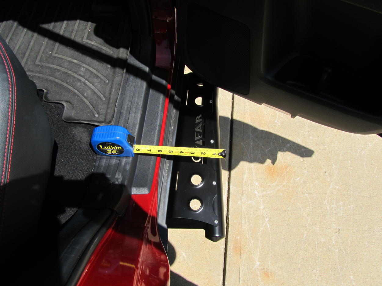

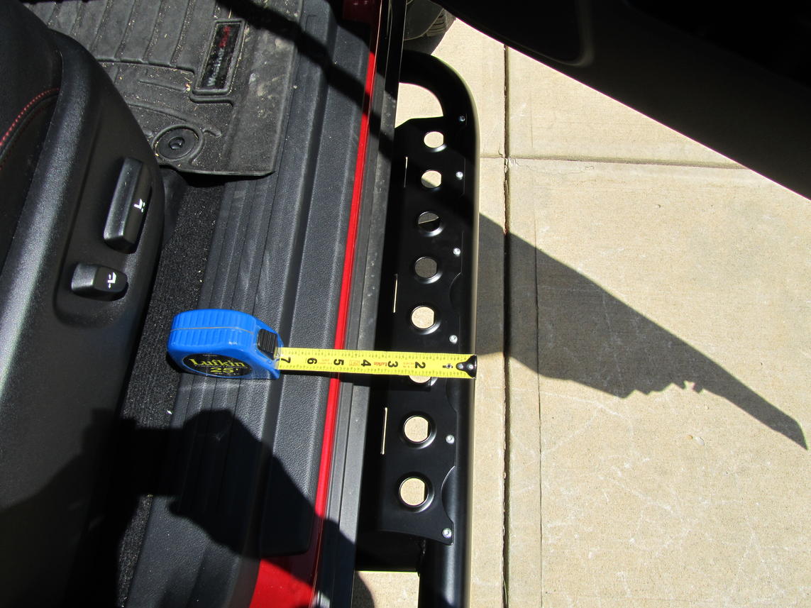

Can anyone tell me how far they extend out at both the front and back doors? I'm unsure if my small kids will be able to use them as steps to easily get in. Thanks

Here's a couple of pictures. Hope this helps.

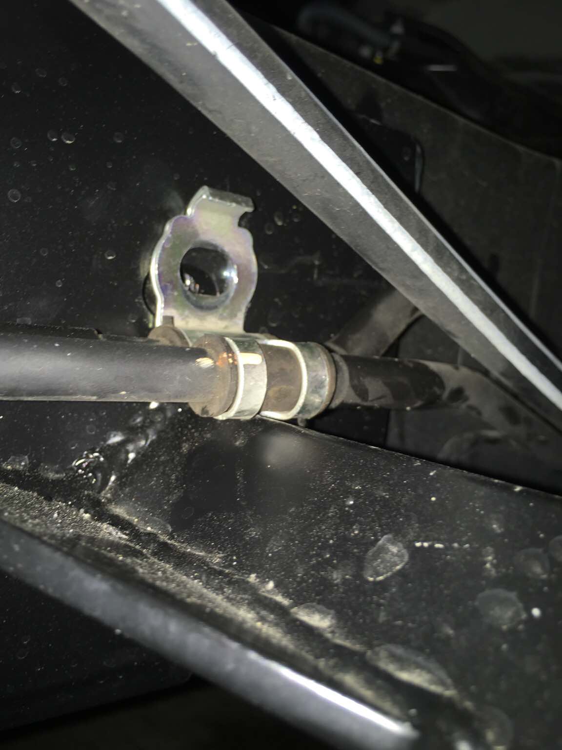

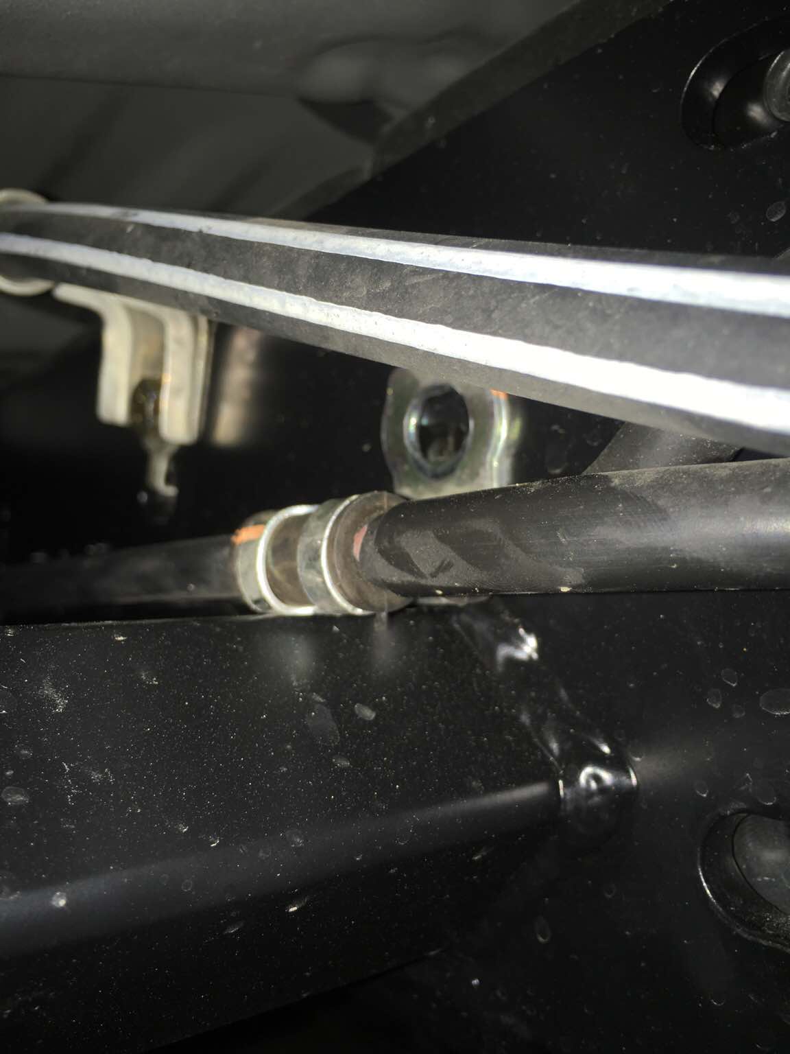

...that said, I'm still pretty concerned about the KDSS lines. Both these pics are of the same bolt hole (rear-most KDSS mount); one is looking back, the other looking forward. I haven't had a chance to get a feeler under the clamp to check clearance, but to my eye it LOOKS like there will be rubbing. Sorry that some of the more interesting bits are out of focus; it's a bit of a pain to get a phone in there and have it focus right, etc.

A friend of ours has a 4 year old daughter and we put a set of our sliders on her 4runner to assist her daughter in getting in and out. She says her daughter loves them and they work great as a step for her!
Thanks for posting up a couple measurement pics

Here are my pictures. Mine are a little dirty lol but look in the same spot as yours. If anyone has any tips or to just leave it. I am all ears.
I know i already messaged you through IG but, im just responding to this post so the other KDSS guys can see it.
The lines will be fine in that location. If they rest on the slider leg it will not hurt them since they are covered by the rubber insulated mounting strap in those points.
