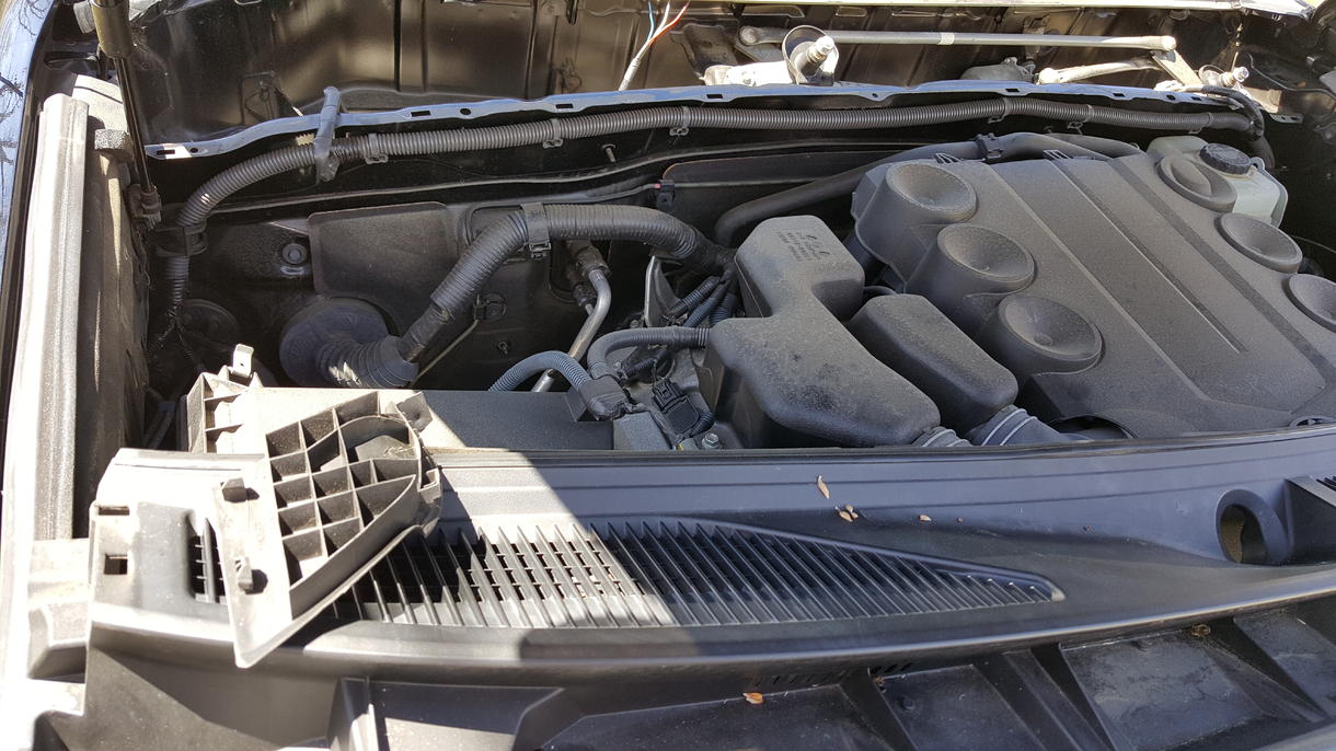

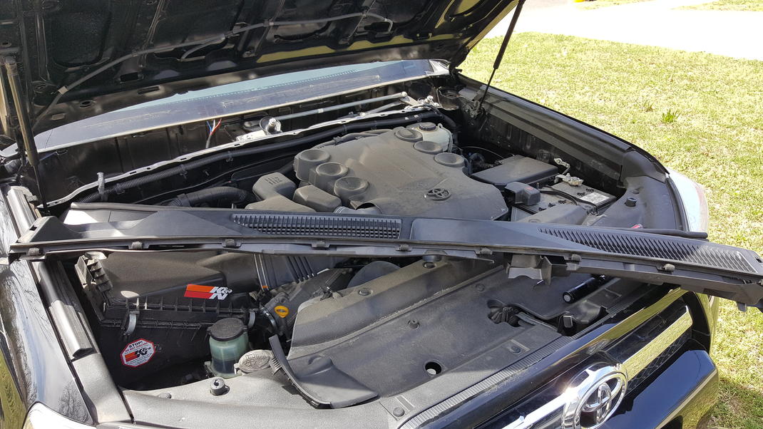

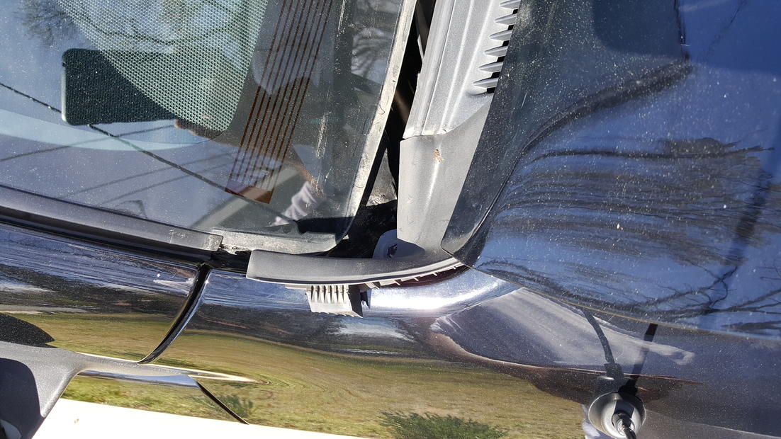

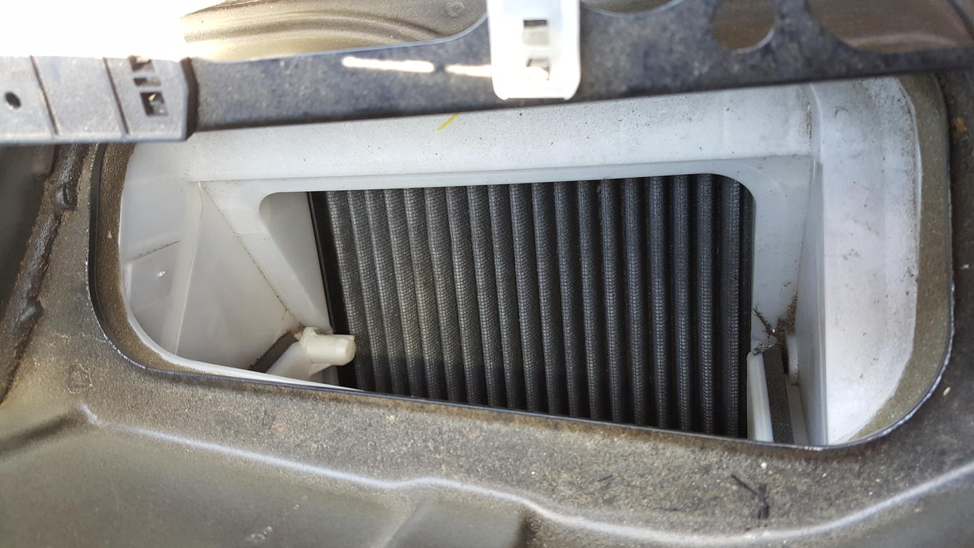

OP...Are you asking how to remove the wiper cowl? I just did that to my
2011 two days ago. If so, you have to pop off the caps covering the wiper arm nut which is a 14mm size if I'm not mistaken. You may have to wiggle arm gently as you pull up. Passenger side was easier for me
to remove with hood up & driver's side with hood down. The cowl has a
plastic push down fastner on each side that needs to be removed. The
rubber shaped end pieces snap onto the cowl. I took the passenger side
off. I left the driver's side on and just disconnected it from cowl.
You can now pull cowl gently upward as it has about 6-7 clips. I used a long
slotted screwdiver to push tabs inward as I pulled up. Didn't want to chance
breaking one. Putting all together is reverse. Very easy.

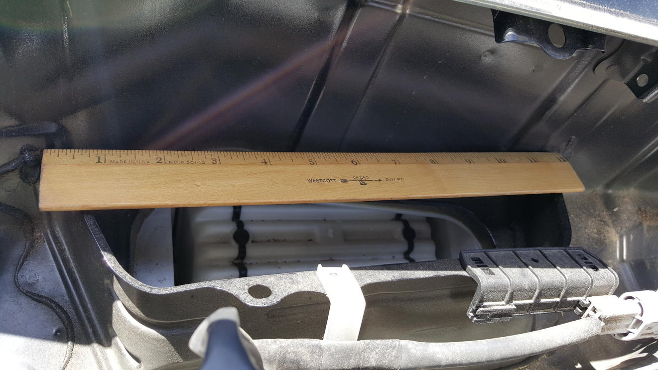

Does this have to be flat or can I slope it a little to get the leaves to slide off? I park wet trees a lot and that's what tends to get in my filter.
You could probably slope it if you wanted. Just sorta leave a bit extra and "pitch a tent" in the middle and use a self-tapping screw into the firewall.
I just don't do it that way because I like to reduce as much hole-drilling into the firewall as possible.
