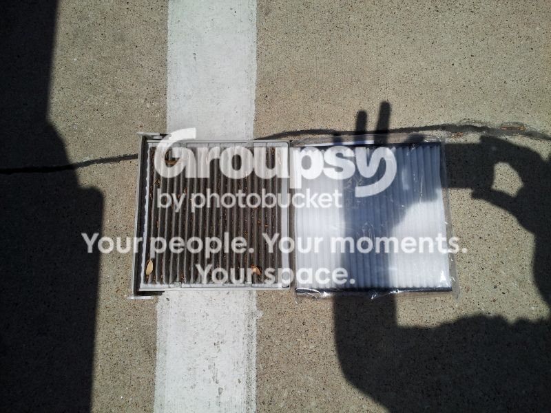

Changed mine today with about 40k, it looks nasty.

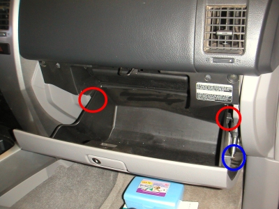

Also, while changing my cabin filter, the piston on the right side of the glovebox is not connected at the top (blue circle in pic). Normally, the instructions say to undo the screw at the bottom to lower the glovebox. Mine's not attached at the top, and I can't tell where it is supposed to attach. Can anyone tell me where it connects?
there should be two plastic pegs that protrude out from inside the dash (where the cylinder part of the "shock" points to when the rod end is screwed in) its easier to attach the cylinder to the pegs with it unscrewed from the box. Someone may have removed it without disconnecting the cylinder from the pegs and posibly broken one or both of the pegs. Mines only held in by one peg lol hope yours are all acounted for.
hmm maybe theres only one peg afterall i just saw the two holes in mine an assumed there was at one point another peg cool stuff.
