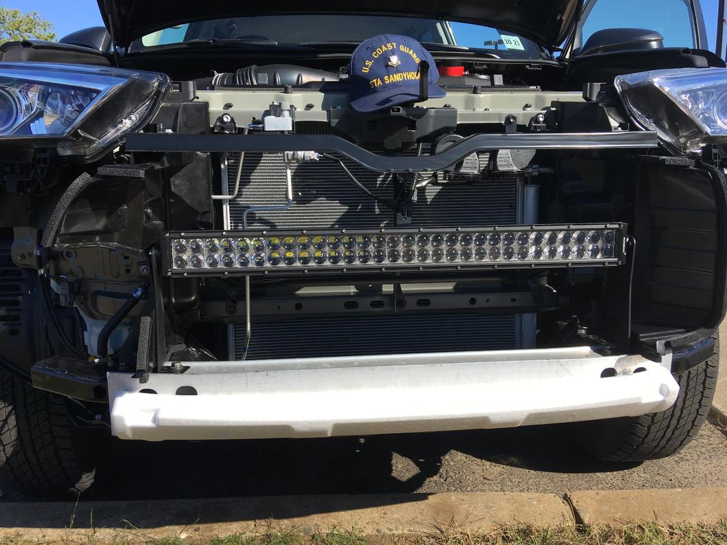

The bracket is very nice. I like the fact that I don't have to drill into the bumper reinforcement and get nutserts, etc. I did, however, have to trim the air dam on both the driver and passenger side. I made little slots so that it just slides in, as opposed to hacking up the whole air dam.
Fitment is OK. It bolts up no problem but the bracket protrudes past the bumper line (if that makes sense). I had to trim my grill since it was pressing up against it pretty damn hard and was preventing me from bolting up the top of the bumper.
The hole where the light bar mounts up to is a slot, so the light bar can be moved forward and aft, which is nice.
Overall, the bracket will require you to trim some things (grille and bumper, if you are really OCD). I personally didn't trim the bumper and just let my bumper sit right against the bracket.

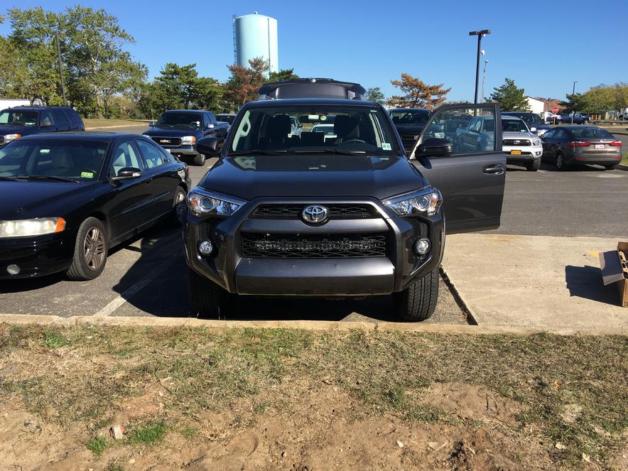

EDIT: added just a few pics of the trimmed grill and also where the bracket rests against the bumper. Doesn't look that bad from picture but it is enough to "deform" the bumper when installing. Fine with me but maybe not for some. I will add pics of the actual bracket later this week.

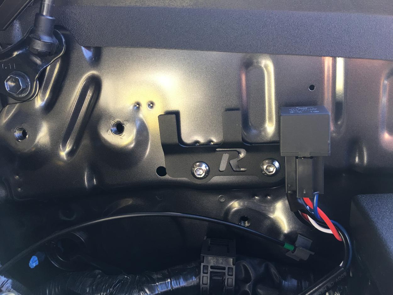

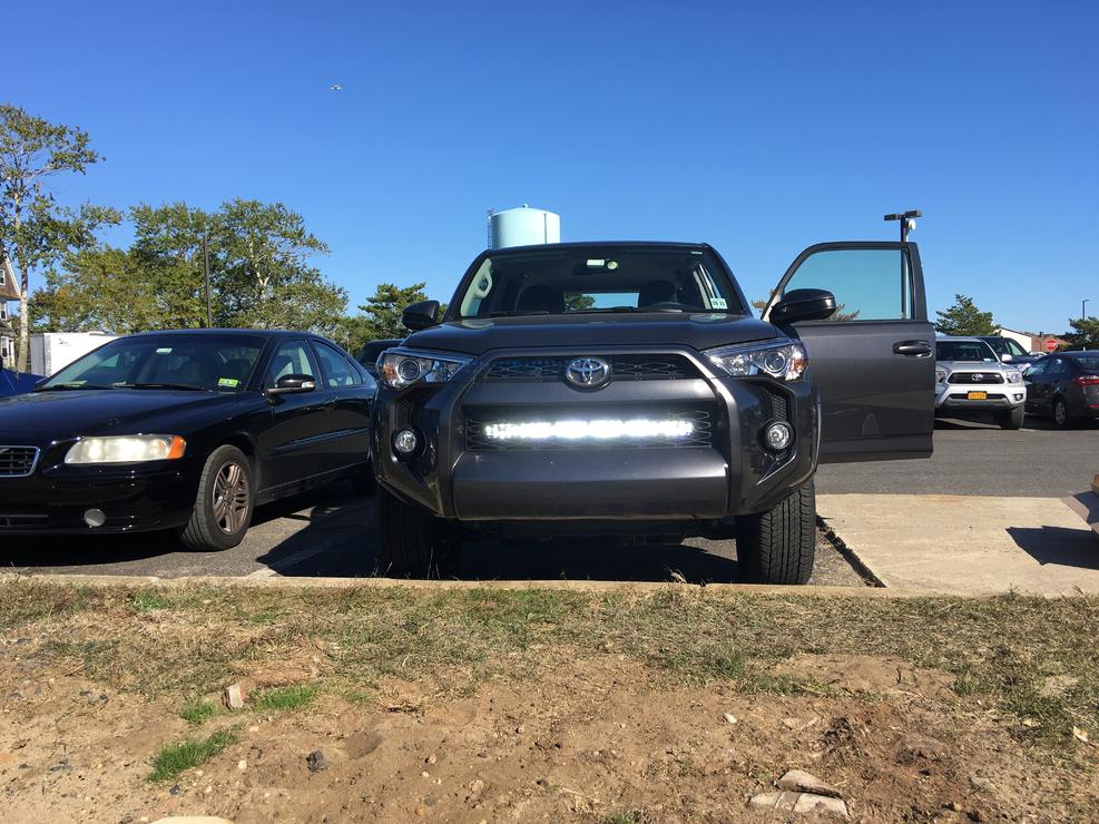

Did the behind bumper lightbar brackets today, turned out great! From start to finish the job took an hour and half. I'll post pics once I figure out how to do it on my cell phone. Shout out to Rago Fab for their excellent customer support and great products.IMG_0475.jpg

Nice product but not worth $50 in my opinion. I spent $9.27 on mine and it took me about 10 minutes to put them in. Cool design and a good company. I will be buying their brackets to mount two spot lights in the near future.

FWIW, I chose to trim my grill because the bracket was pushing up against it a bit too hard (enough to deform the bumper when reinstalling the upper clips). After I made those relief cuts in the grill, the bumper went on without any effort. I tried shimming the bracket, moving it within its mounting holes, etc so that I wouldn't have to trim such an expensive piece of plastic but in the end, I'm glad I did.
I ended up trimming out the grill entirely where the light bar itself sits, and pushed the light bar out as far as possible. This gave me the maximum light output possible.

that is a cool install
