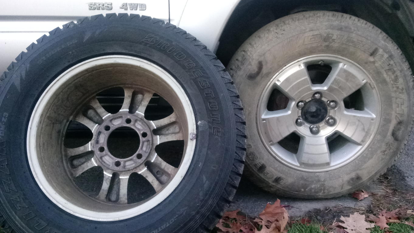

So yeah.. Tried putting some new to me 6 star 17" rims with pretty new winter tires only to find the damn thing was hitting the front caliper on right side.
Now i have to leave one 5 star 17" rim on until this can be figured out or i put a grinder to the caliper.. Grrr!!!

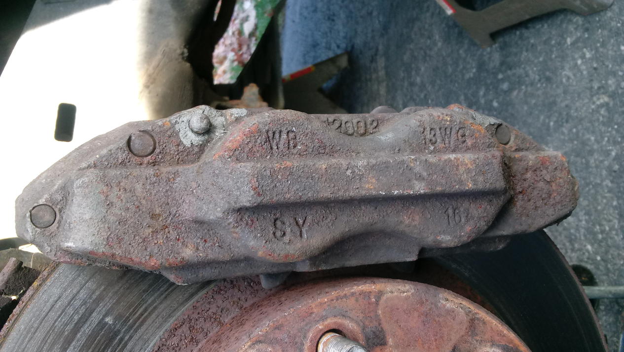

You have the SR5 so you don't even have the larger sport edition brakes right? Maybe the rubbing side has an aftermarket caliper? Doesn't make much sense to me why it wouldn't work.
Yeah.. As far as i can tell; the calipers on both sides look the same but the pass side doesn't have the markings/numbers on it. The driver side has some wheel play because the hub/bearings need replaced ( waiting for them in mail ) so not sure if it's not hitting on that side only because it's loose or if it is hitting pass side because it's an aftermarket caliper and slightly larger housing.
My bet is it's probably an aftermarket caliper but it could also be that the wheel bearing is bad or is pressed on too far. Those SE wheels run super close to the calipers anyway. Do all the wheels hit the caliper? Maybe one is cast different as well.

You definitely have something wrong with your calipers/hubs/rotors or you have an aftermarket caliper. Those 17s are the sport model and they came with the 13wh calipers. You shouldn't have a problem..

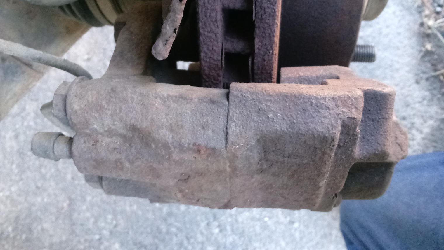

Attached some more pics.

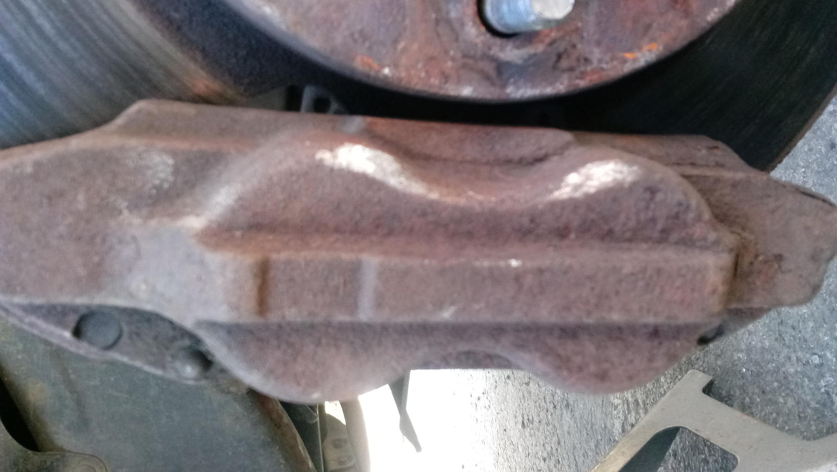

Driver side markings. Passenger side none but pic from above looks like caliper halves are a little off.. i tried measuring everything and it all seemed the same from driver and passenger side.. Caliper to studs and hub etc.

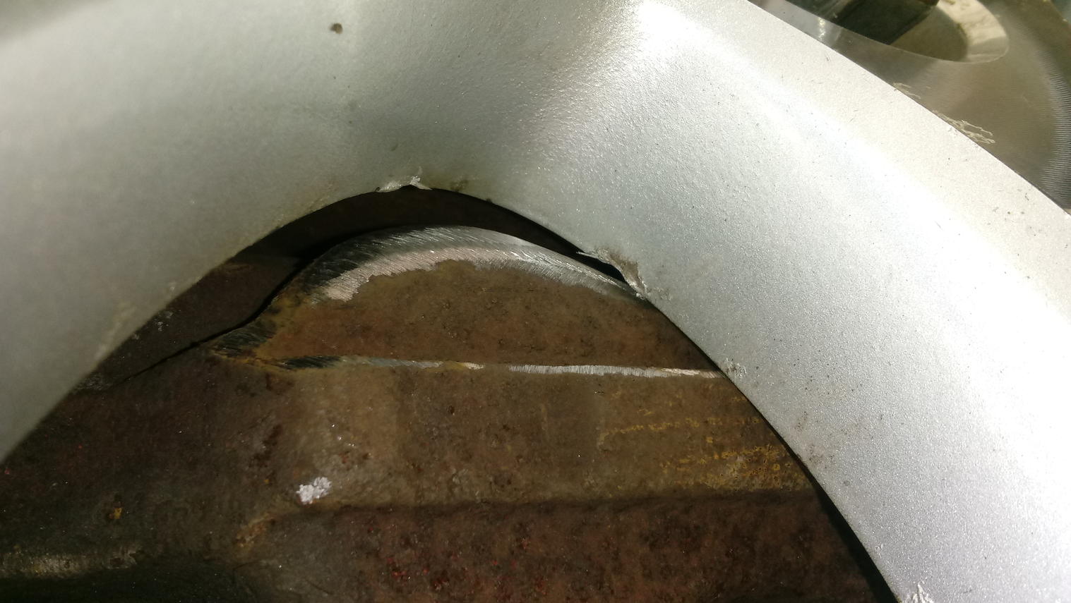

See how bad the thing hits even after trying to grind down?

I’ve never seen an OEM wheel make contact with the caliper. That caliper looks suspect.
I have a spare 6 star like the one hitting, i put it on and it hit too. Must bevthe caliper then. Don't know what it's from but guess not supposed to be on the 4runner.

Replace the caliper. Looking at your 2nd and 3rd pics I see the piston pocket area on the pass side caliper is sitting closer the the hat of the rotor than the oem driver side.
