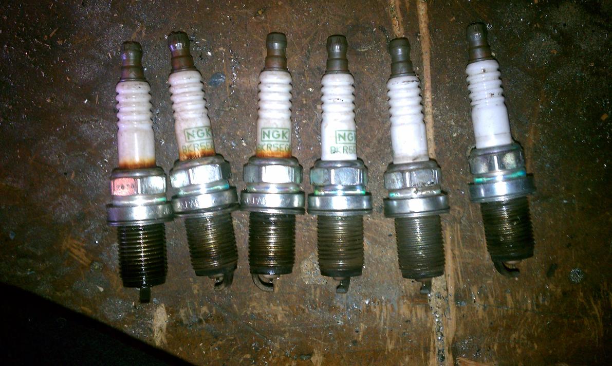

so I got one more pic that is kind of interesting. These are the spark plugs that i pulled out of the engine. The ones on the left are the right bank cylinder #2,4,6 and the left bank for the last 3.. cylinder # 1,3,5.. I noticed how the ones on the left were kind of burnt on the ceramic portion of the plugs. this is also the side I had the Miss fire code on.. (#6) the side the gasket was bad on.
Anyone know if the burnt parts are definately from the blown gasket?

The plugs can look like them when they run hot; I'd recommend running the dual plugs all around when the heads go back in.
The top of the piston is that clean due to the coolant leakage on that cylinder. Otherwise, I really can't see of anything wrong but I would take it to a machine shop to have them look it over for non visible cracks.
The Fel Pros should be fine.

Good job on getting them out! It looks like in that last pic #6 is the culprit. From what i've heard felpro is good stuff. As for the plugs I'm pretty sure the manual is very specific on which ones to use, so I would stick with those...

Yeah I recently learned that the runners are suppose to have the dual prong NGK's... I'm still learning.
