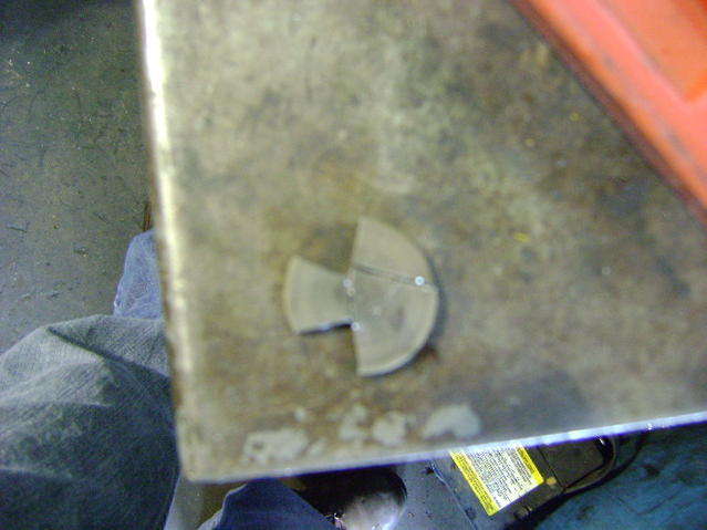

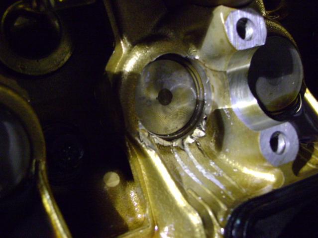

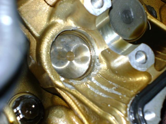

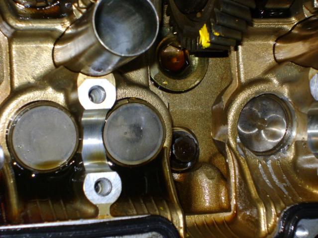

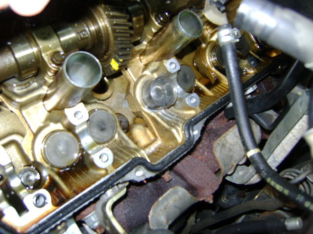

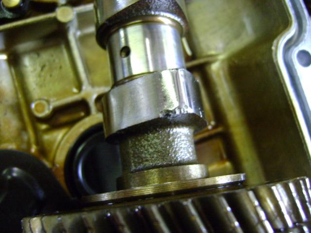

Long story short, family member has a 2000 4 runner lmtd 4x4 that sat undriven for 4 years. Only has 46K miles. I have tried to buy the truck for years and finally he let me pick it up to see if it would run or not, (pics to follow soon). Covered in grime, put a new battery in it and it did fire up, but had had a major dead miss. Got the valve covers and intake off, had 4 stuck valves. All came loose, but on driver side bank, one of the actual valve lash shims has broken off, valve itself is not compromised. Its a round flat metal cap on top of valve where it meets the over head cam lobe. Only found one small broken part on top of the head, rest is floating around in motor somewhere. put a scar on cam lobe and on the head near that area, but should not effect the performance if cap is replace and scars sanded.
Has anyone had one of these shims break????
Engine has good compression across all cylinders except this one. My mechanic thinks remove cam, sand down areas with damage and replace the valve shim. Any thoughts? I am thinking go ahead and replace cam for sure, but trying to avoid pulling the head,

Any other history on this engine? That engine just doesnt f*ck up cams and valves by itself. Especially if it has 46k on it.
there is something more to it than just that. I personally havent seen a yota engine do that. Unless the cams were matched with the wrong sized shims and the cam caps werent tightened down to the correct Ft lbs.

I'm thinking your best bet is to get another head from a junkyard. Be sure to replace the timing belt and water pump while you're at it.
Headway
Shim is ordered from dealer, $8.80 and includeds overnight shipping. The valve moves freely in the head and sleeve will trun by hand. Plan now is to roll the dice since the truck probably has more issues that need to be dealt with. We have sanded down the edge of the cam lobe and area at lip of valve galley. Going to replace the shim and install orginal cam as to not upset the other valve clearances and let it roll. If the truck runs and checks out in all other areas fine. But, if I go ahead and do the major top end overhaul and have other major issues that sux. Need to drive this thing before sinking any big money into it. All but one small part of broken valve shim is accounted for, probably down in the pan. I also misread the miles when I picked it up, ONLY 43K MILES!!!!!

The resurrection continues, should have it bolted up and running by Tues afternoon as long as shim comes in from dealer, and will report back. thanks again for input.
ITS ALIVE!!!!! Running and test driving for 3 hours now, ran fuel system clean, but still has a pesky miss on Cyl#6, (not the cyl with damage valve shim). Thinking along the lines of clogged injector at this point. Still has 1/2 tank of old gas mixed with 1/2 tank fresh and seafoam. will continue the driving and post picstures to show how bad the paint is under the grime.
