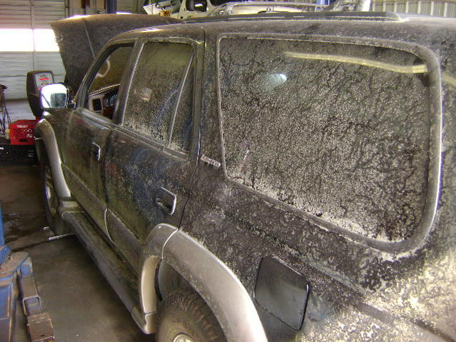

Paint no too bad

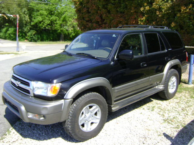

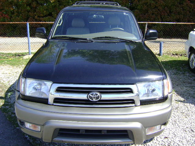

Before and after pics, have not waxed it yet, so may look even better with high speed buff.
