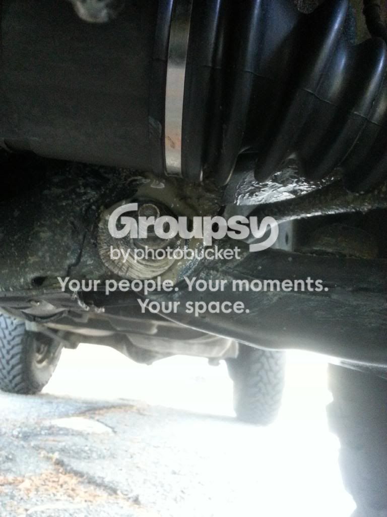

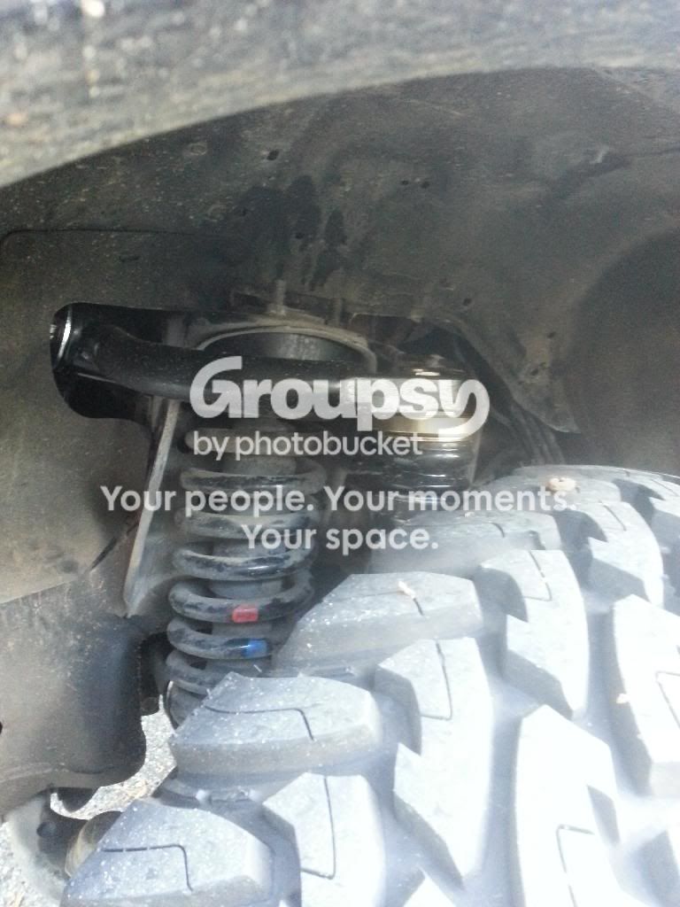

put a daystar 2.5" on my 98 4runner 4wd about 3months ago. After the install I did an alignment and my caster was roughly 2 deg off and the truck drove like shit. I then bought some adj uca from fat bobs. Now my caster is great but my camber is off ive got the uca all the way in and the lower cam bolts all the way out. What do I need to do or what am I missing?URL=http://s203.photobucket.com/user/boosterror/media/20140406_152501.jpg.html]

The ucas are on the correct sides 100% sure of that. Lower cam bolts are maxed out. Bushings have some dry rout but are still holding there shape.

Can we get some pics of the top of the UCA's? Correct me if I am wrong but it looks like your camber is to positive. I had LR UCA's on my FJ and I thought you just moved the nut in and out. Can you move the nut on top of the UCA in?
