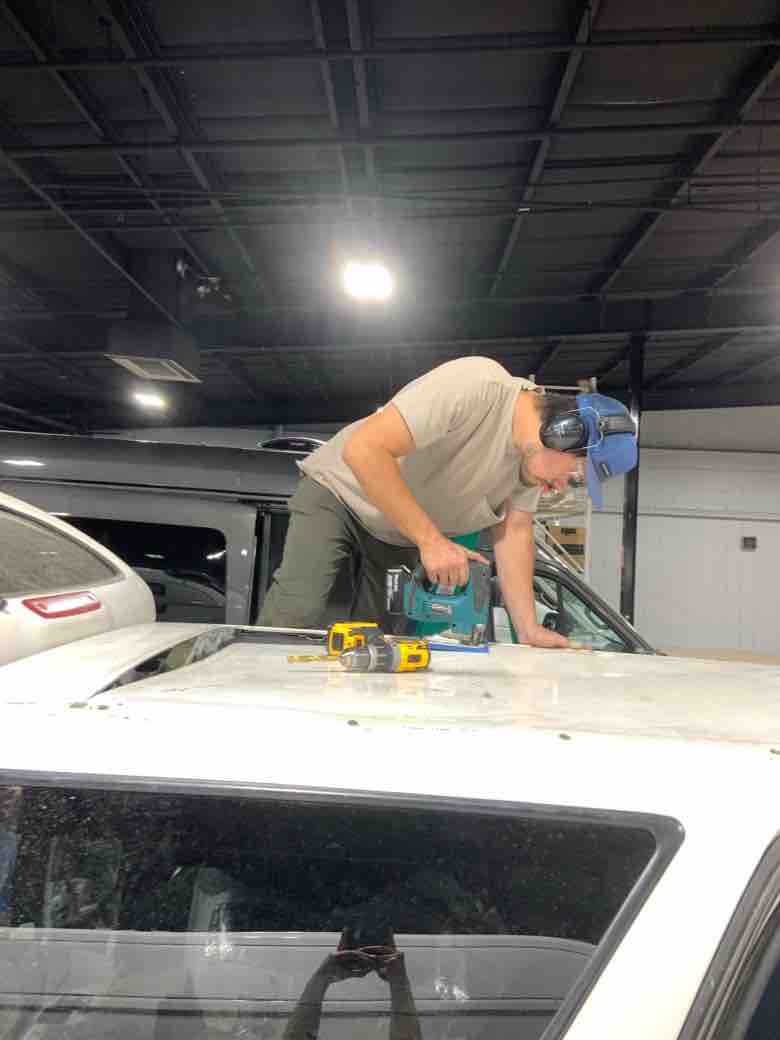

Cutting holes..

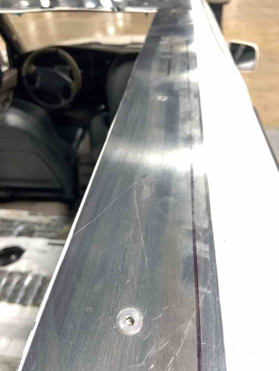

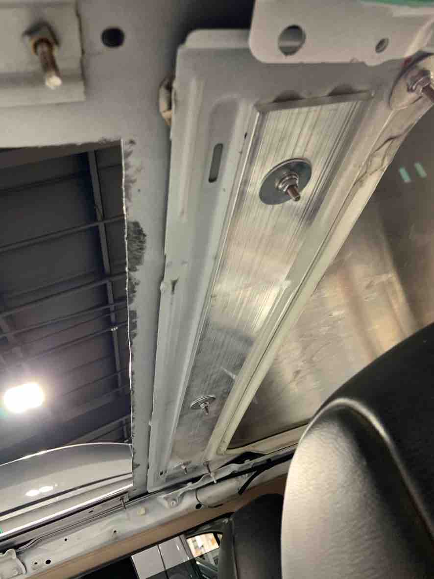

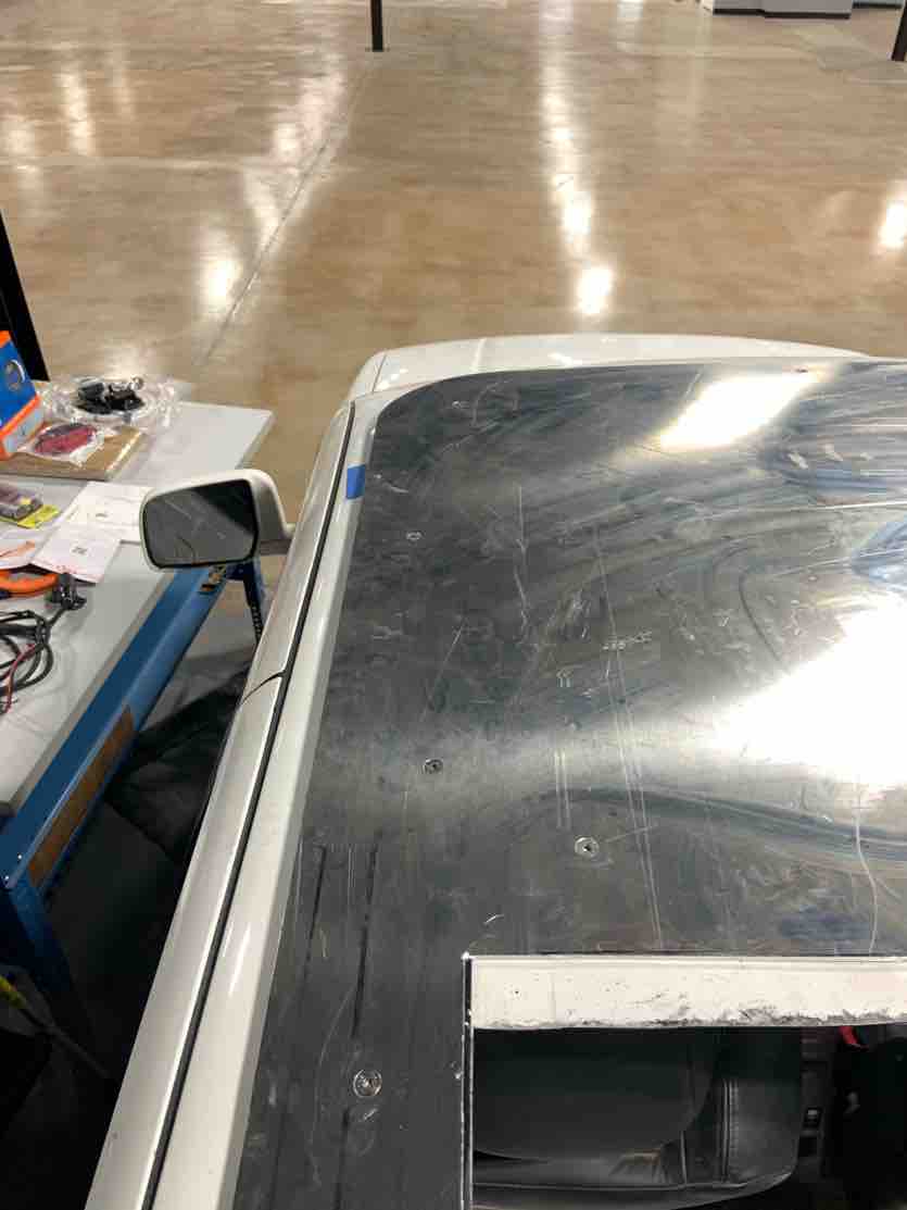

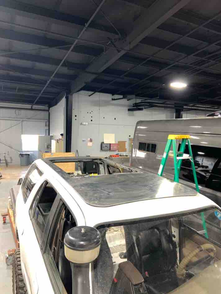

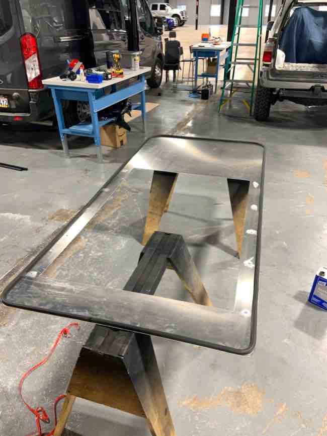

Almost finished with the roof conversion. Aluminum sheet is sealed and bolted to the roof using existing roof rack nuts and through bolting with sandwich plates. Outer foam seal and sika 252 to weatherproof.
The aluminum plate will get an adapter on top to attach to the tent.
I’m very impressed by how stiff the roof already is with the addition of the aluminum. I still plan on adding a roll bar to tie in as well though.
