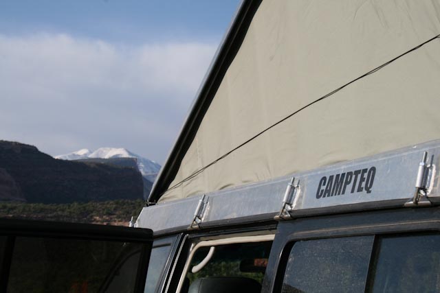

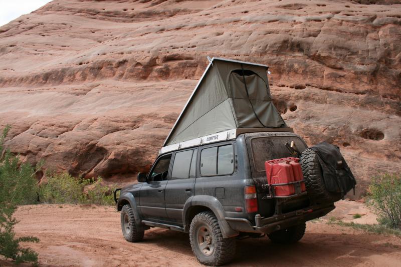

Removable pop top conversion for 80 Series Land Cruisers (91-97)

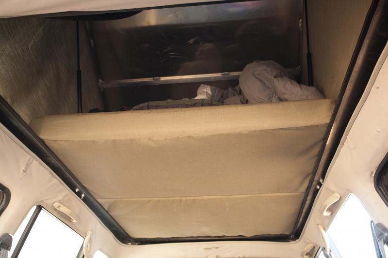

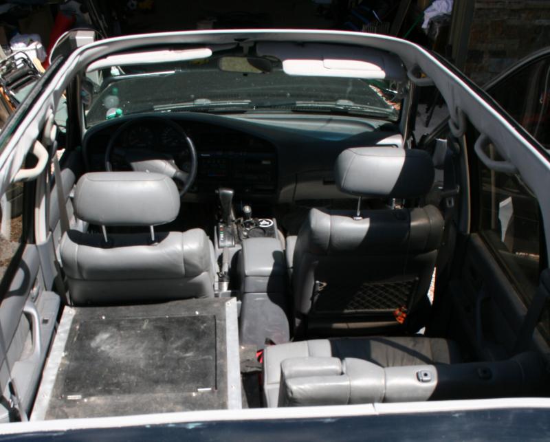

Accessible through factory sunroof, aftermarket rear sunroof, roof cut away, and from the exterior of the tent.
4 solid rain gutter mounting clamps mounts the hinge top to the well over built Toyota Land Cruiser chassis

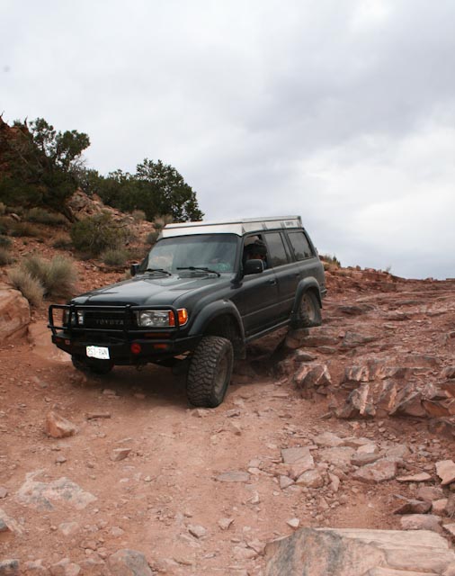

Designed to be a low profile camper option with little to no extra wind drag, Lighter, larger roof loads like longboards keep a low appearance to help with drag.
Comparable fuel economy with Westfalia 2wd, Syncro, and 2wd Sportsmobiles with much higher offroad capabilities
Upper bed has similar dimensions to a Westfalia bed
Designed and constructed in Colorado using recyclable 1/8" Aluminum in a solar powered facility by the most talented craftsman.
Living rubber hinges are tested to 50,000 flexes and provide a weather tight front hinge
Estimated material weight of less than 120lbs without cushions
Outdura fabric on walls and cushions are soft to the touch and provide a mildew, rot and water resistant yet very quiet and comfortable sleeping area

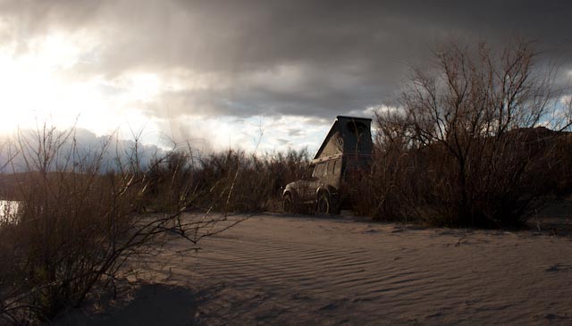

Photo's from prototype V.1 on Kokopelli trail:

Wait, so you cut the factory roof out of the truck?!? That's pretty irreversible!
Thats correct and yes its very irreversible. If you where to do this, you would be CAMPING a lot or planing some form of Expedition. This wouldn't be daily driver's option, IMO.
