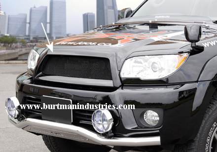

If you buy '06 headlights, you'll need either an H11 HID kit (like most who do it) or an H11 socket and bulb for the low beam. If you want to use the integrated '06 blinker/DRL you'll need two wiring harness for the signal/parking light and tap that into your '03 signal (~$20/ea). You also need the two plastic filler panels that go below the lamp (~$30/ea). There will also be a small triangular gap at the corner of the lights, which can be fixed by modifying an '06 grille or ignoring it.

The tail lights just look like they do on any '06-09, they don't fit any differently.
There are pictures elsewhere on here that show the small gap for the '06-09 lamps, otherwise they fit the same.
