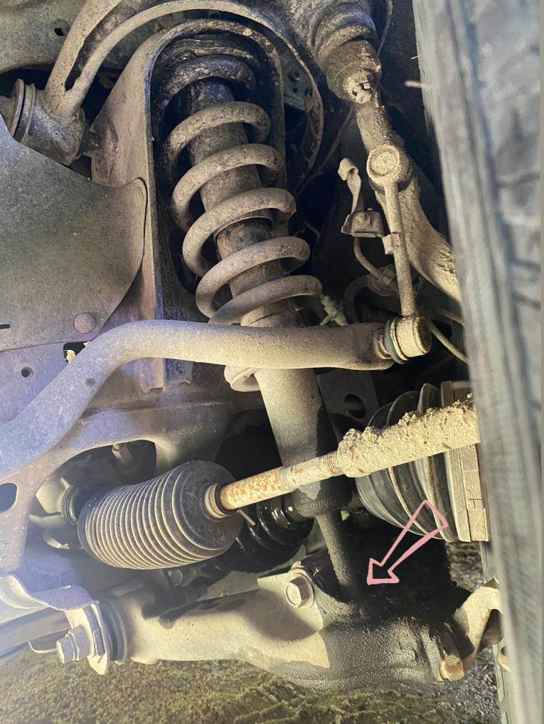

Can i drive with this broken part?
Nape4
Hello guys
This part is broken in my car

I thought its called suspension but its too general
My broken part called strut?
And can i drive with this a little bit?
Thanks!!
can you explain what part is broken better or add a pic? 4runners dont have struts, they are shocks.
Thanks for answering me!
Yea so i think its the shock
Where i put the point its actually broke for two pieces
I would only drive slowly a short distance to a shop to get it fixed. Any more than that, like a commute, not a good idea.
The shock/spring is what is holding up the vehicle and if it pops out of that pocket when driving, the vehicle will compress a lot on that side and maybe bend some more parts.
If the shop that's going to fix it is around the corner, maybe.
With that shock eye broken off, there's nothing controlling that wheel. The end of the shock wedged in there is holding up the weight of the truck, yes. However, under cycling load, it could pop out and really f*ck some sh*t up.
If you're concerned about your safety and others around you, it would be wise to tow it to a shop and have it fixed.
It is definitely not safe to drive.
