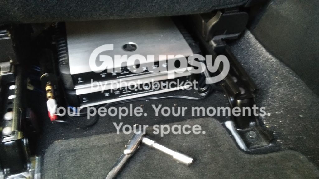

I have mine under the passenger seat here. It cannot be seen no matter how far forward or back you have the seat.
It is not completely mounted in this pic, but it is tucked up to the cross beam so the carpet lays over the edge of the amp, covering the wires.
In this pic, you can see the floor vent. The amp sits above it to allow the air to still flow. I placed thin boards under the carpet on each side to raise the amp and have something to attach it to.
I want to avoid under the seat, unless it can be hidden with the seat in any position... I'll have to toss it under and look.

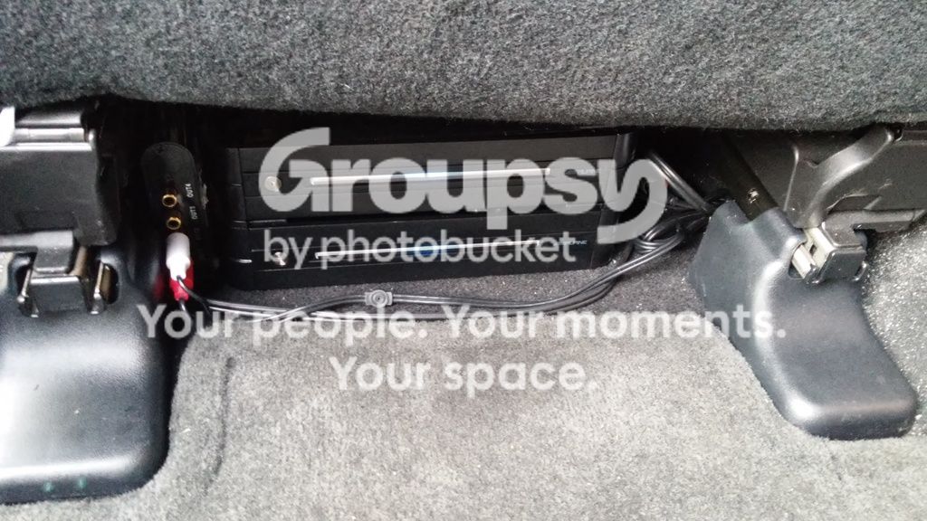

Using the space underneath either of the front seats is a great choice for a variety reasons... easy service access, short wire pull, temperature controlled environment, power-seat "Trac-well" provides physical amplifier safety...etc! I've had two different sets of amp stax under the driver-seat:
DUAL JL AUDIO HD-750 mono-block
20150807_091038.jpg~original
DUAL ALPINE PDX M-12 mono-block
20150807_182820.jpg~original
I understand that you need to create the illusion of an OEM (factory) amplifier component in which case I'd still recommend the RR wheel well vestibule location. Wires are very easy to pull using the passenger side door sills as the wire trough. BTW: You still haven't mentioned what type of amp e.g., size, #of channels, power in watts, application...etc?
