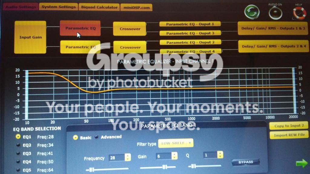

Have you considered using a "miniDSP-in-a-box" processor? The reason that I use it is because it's a 'software driven' Stand alone device that gives me 'TONS' of professional audio system control through it's (expandable) parametric eq. The hardware takes up no more than 4 'cubic inches' of physical space, take a look:
_mg_0646.jpg~original
I've had issue with outboard EQs causing electrical noise when paired with the PDX before. Hmmm...
The "miniDSP" is software driven (digital), and so can create no noise of it's own. This device is operated by what is known as "a plug-in"; just a fancy word for a software program that's used to drive the hardware. And here's what you'll use to control the 'on-screen' audio signals:
6 HIGH AND LOW-PASS X-OVERS
2_way_Advanced_2_505bd4ba35a0a.jpg~original
12 BANDS OF "PARAMETRIC EQ" ...six bands on the front-end, six on back-end. All have adjustable frequency centers!
The "miniDSP 2x4 kit" costs $110 bucks for the hardware and $10 USD for the "plug-in" (firmware) download; which you'll pay for ONCE! Adjustments to your audio system are made via a laptop 'In Real Time', so you will hear the changes as you make them. When you're done making the periodic adjustments to your vehicle's sound system, just unplug the micro-USB cable and the changes are saved to the system! One of the best things about using the miniDSP to implement system EQ-ing is... no dashboard installation, trim cutting, or space negotiating in the cabin because the program resides on your laptop; only a 4" x 4" x 2" circuit board will remain in the truck to process your 'pre-determined' filter settings; here's a link to the miniDSP kit:

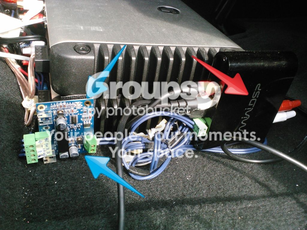

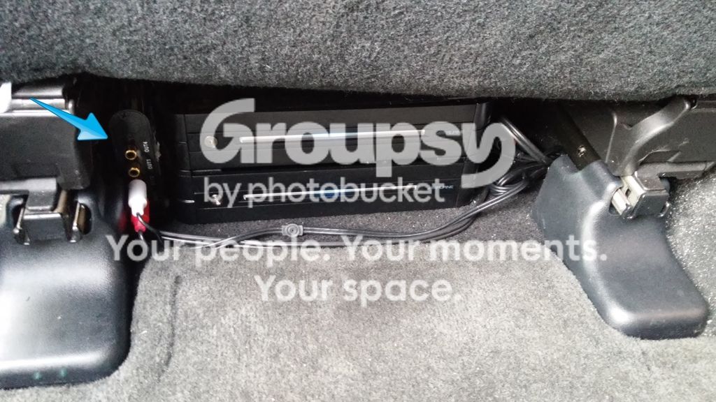

I thought this photo would give a better idea of the actual size context of my "Sub-bass processor!" "see the BLUE arrow!"
...and that's it! The only other thing that I was advised to install was the "miniDC Isolator/Amp stage sequencer!" https://minidsp.com/products/accessories/minidc-isolator/. What this does is, it brings up/down your system components in the proper order e.g., EQ/X-over then the amps last... to prevent the electronic audio equipment from releasing a power-up/power-down... "KA-BANG!", that could 'potentially' cause substantial damage to the subs from the power surge as it enters the audio signal; this uses the reverse "In-sequence" order to shut-down all of the electronics to protect your investment, cost is $12 bucks!
See the 'mini-DC Isolator-Sequencer' in the photo as highlighted by the two BLUE arrows, and the 'miniDSP-in-the-box' with the RED arrow accent!
Rgds!
