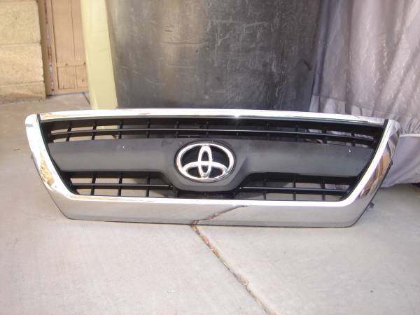

Really hate the chrome on my grill and found this grill for sale for $40. Can I stripe the rest of the chrome off of this one and paint it a glossy black? Any other ideas?

Search plasti-dip on here. It's probably exactly what you need. No commitment and no damage. You can peel it off and go right back to the original finish.

This will get you to a more glossy finish. Amazon.com: Performix 11212 Plasti Dip Enhancer Glossifier Aerosol - 11 oz.: Automotive
The only prep work you will need to do is make sure the surface is clean. No need to scuff, prime or remove the chrome. Apply around 3-4 coats of black plasti-dip. Let cure. Apply 2-3 coats of glossifier and you're done. Make sure anything you tape off gets pulled off immediately after the last coat.
If you can find color match paint, you can paint over plasti-dip, but it will not peel off quite as easy if/when you get ready to remove it.

I tried painting my chrome grill twice. I sanding it, prepped it and even applied etching primer. And it paled within a week or two. Finally replaced with a black plastic abs limited grill.
I recently ordered an OEM LIMITED (about $190) grill and was really suprised when it showed up complete...I thought it would just be the outer rim...but the paint is really thin, probably wont be too long until I have a repeat of the same problem.

I just took that fake chrome off my my 3rd gen grill.
It was a complete pain in the ass, but some good me time!
I used WD40, degreaser diluted and non diluted, all of that did NOTHING!! basically, I had a small knife and a big knife and I found a starting point and then just peeled it all off...not even heat worked...but, it's all off now. I sanded it with 8p grit, sprayed primer that is now drying, tomorrow I will prime again then sand with 180 grit, and apply satin black paint.
