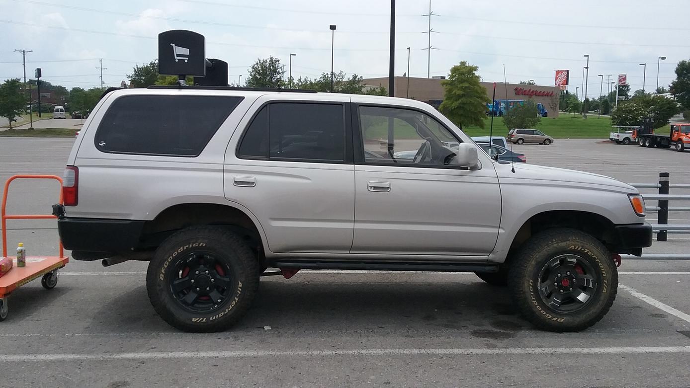

Here's mine with OME 890s in rear on 99 talls in front. I probably have 100# of stuff in the back.

I run stock front with OME 891 rears. Perfect setup for the money. Really fixes the sagging rear problem of the truck, and leaves some room for heavy loads in the trunk and pinning a trailer. I find the ride to be firmer than stock, but I do prefer it.
Also looks pretty nice with the back of the truck up a bit like this.
