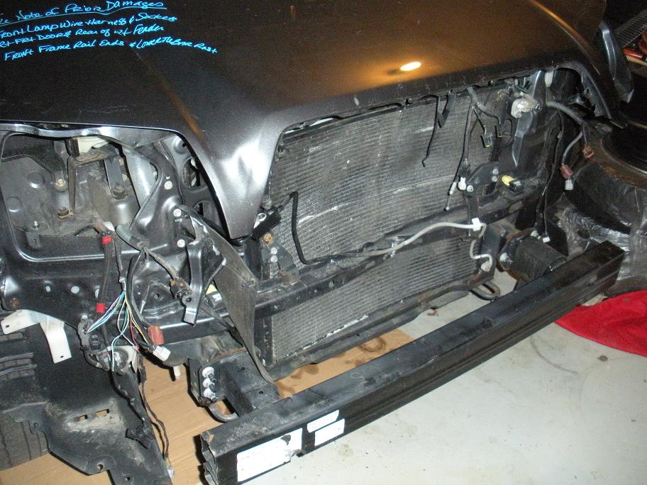

(and, there should be a picture of the damage attached, if I did it right at least)
