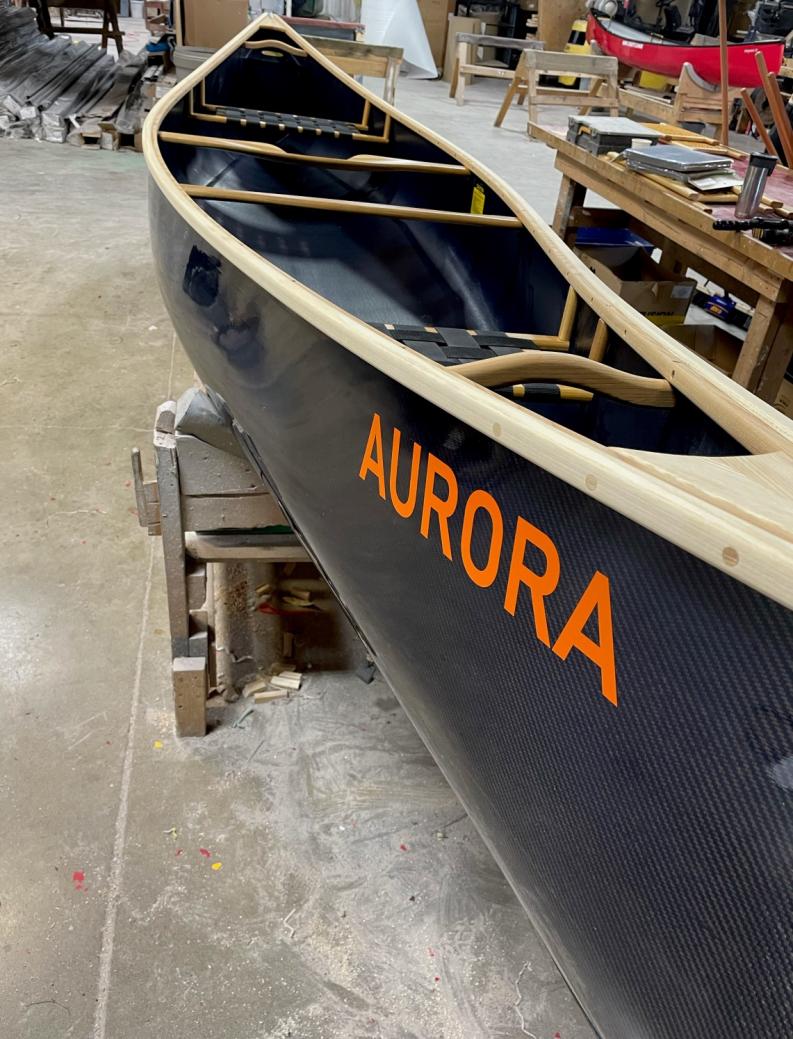

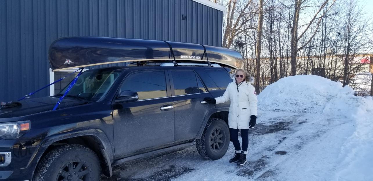

I used Thule crossbars and the factory side plastic rails to mount a canoe. ITs workable. But to be blunt its a shit way to haul stuff. Get a better rack and do it right..course I guess you havent really lived until you see the Kayak go flying off the roof and right through some guys windshield who was tail gaiting you ....
Better be safe. Use the right rack and cross bars.

From the original post it sounds like they have NO crossbars at all and wants to create cross bars using ratchet straps, then put a canoe on top and ratchet strap a canoe over that.
YEah without crossbars it will likely crush or dent the roof..its abit thin up there
