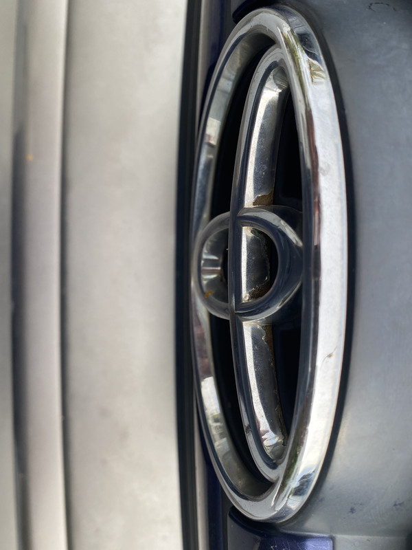

mine is a 98 SR5 w/ this bumper
5.50in is what I measure w/ a machinist's square and steel rule
But this will wildly vary depending on hole/mounting bolt tolerances......

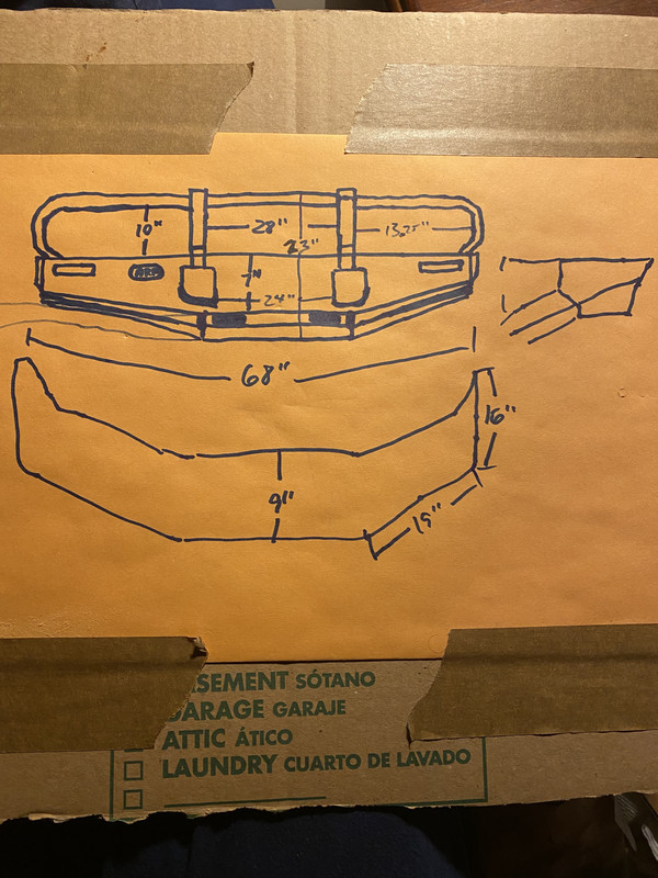

Back when I lived in Texas I had taken some rough measurements of an ARB bumper. On a hand drawn sketch I recorded the top horizontal plate as having a total depth of 9 inches, so the bumper must tuck under the front edge of the grille 3.5 inches.
