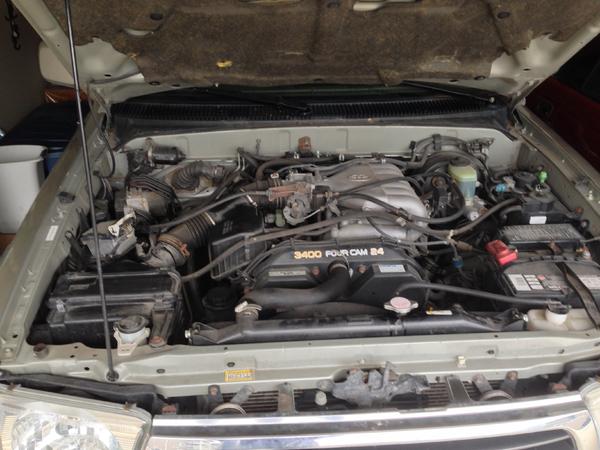

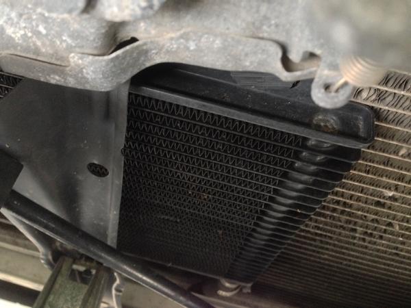

Hey guys I took some photos as asked, let me know what you think.
Under the hood
Transmission Cooler

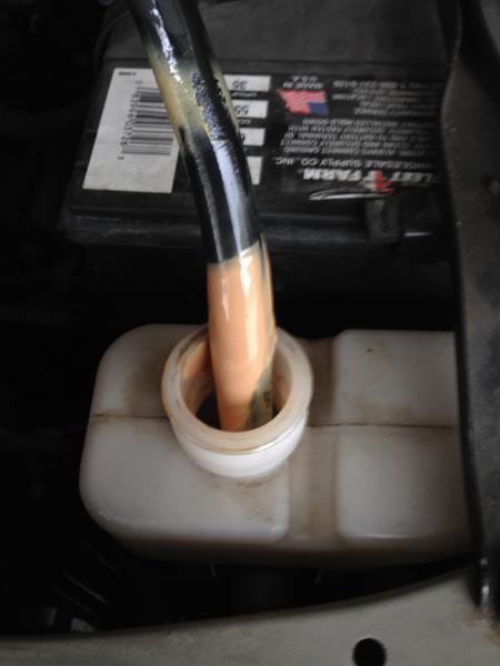

Reservoir tank has milkshake in it. I had cleaned it all out
themikeofmikeness-albums-milkshake+part+2-picture26845-reservoir-tank-has-milkshake-i-had-cleaned-all-out.jpg

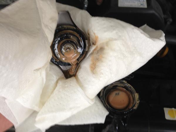

Under the cap

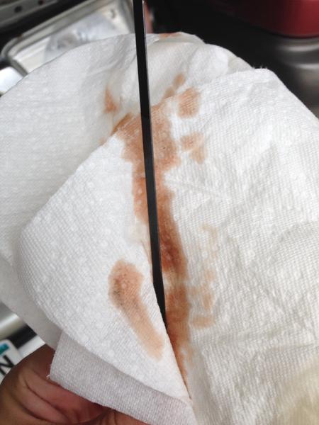

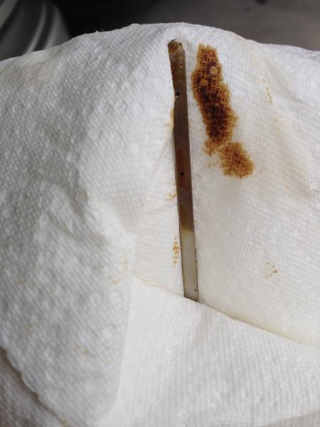

transmission dipstick
oil dipstick

To me ... Of all the pictures the trans dipstick and color looks the most normal.
It looks like engine oil contamination to me. Check your engine oil cooler. Or just remove it and replace all the o-rings. And drain oil and refill with something like Supertech from Walmart for now till this is resolved. Also you can borrow a combustion gas tester from a autoparts store to see if any are present in the antifreeze.

Looks to me like you just need to flush your cooling system better. Oil looks fine (dirty but fine) and the tranny fluid looks fine, but it is harder to tell. Can you get some more maybe in a little cup? But with what I see there it is fine.
What I think happened is you just didn't do a very good job flushing out your coolant system, and that has since whipped up into what you see there. Flush it out well, put new coolant in, and monitor.

EDIT: On second look, get more oil pictures too, it looks a little brown, but again hard to tell with the pictures.

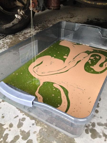

So, I decided to go ahead and pull the plug on the radiator just to see how much milkshake I'm dealing with. Surprisingly, as the picture will show, there was barely any. I only had time to do one flush tonight, but plan on doing a couple more before watching some fireworks tomorrow.
Then my plan is to get one of those combustion gas tester things and see if I have a bad head gasket. Any thoughts?
Pulled the plug ... and this is what i got!?!?!
Looking at the picture of the oil dipstick ....
How many miles since you changed the oil and filter?
I'd look into the engine oil color/crud as a concern.
