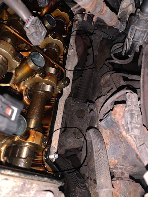

To those of you who have drilled out those bolts on the lower side of the V8 or just in general. If you would be able to recommend what tools, drill bits, extractors you used in the process that would be very helpful.
I’ve had my lower valve cover bolts sheared in half still in the vehicle for the better part of 4 years and with some questionable problem solving I’ve only had a minor oil leak consistent for that time (not my proudest). This comes after
my local mechanic also tried the welding nut and told me engine was going to have to come out but I was not in the works for that.
Attached is a few photos of what I had and still looking to get fixed. 05 V8 260K

If you still have some of the broken bolt sticking up above the gasket surface you can try using "shoulder nuts" as I did. They are shaped like a "top hat' with a tapped through hole. See the post above yours.
