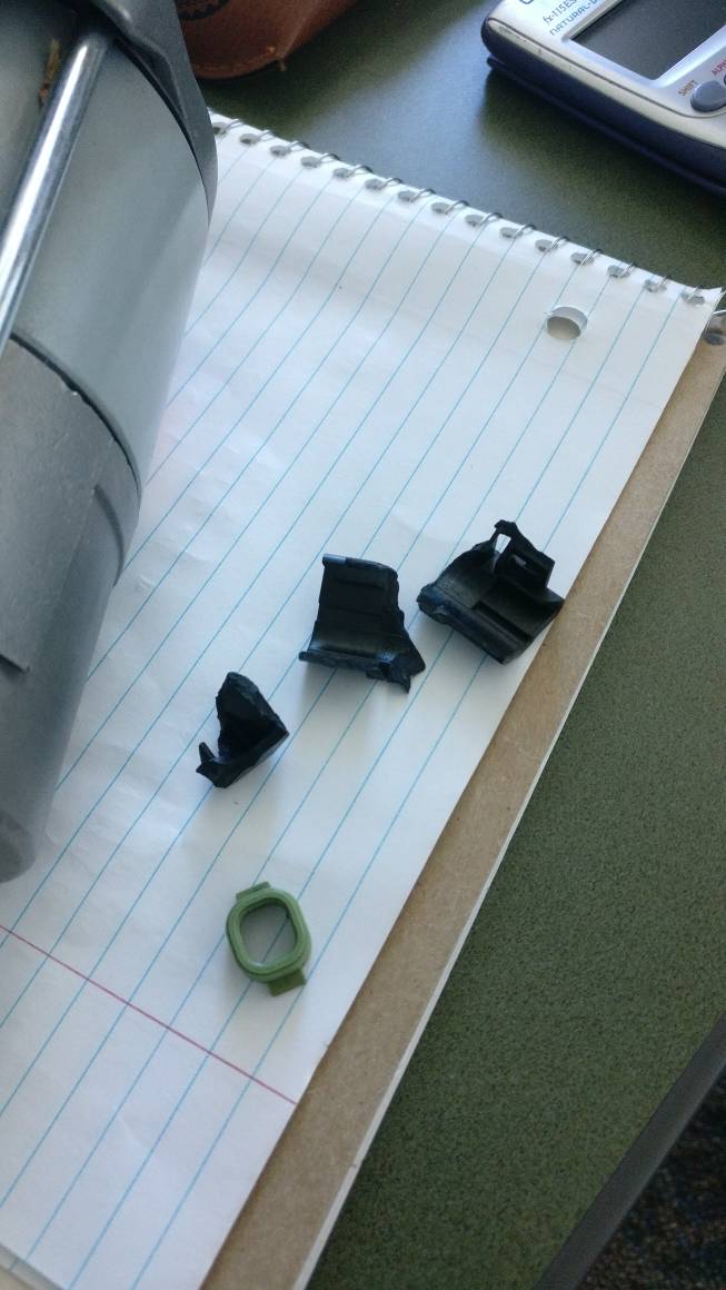

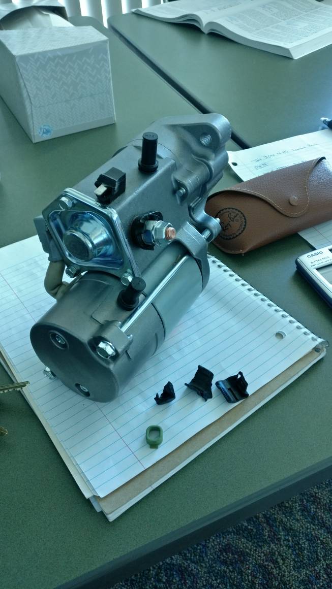

Well my starter went up in my truck and the replacement denso unit came today. Great! Except I opened the box to find one of the clips is broken. Not great. Do you know if this piece can be replaced? I'll post pictures of what I mean.
My problem now is that I've gotta get my truck running asap and can't wait for another starter in the mail. I've already contacted the place I bought it from and am waiting to hear back but like I mentioned I really need to make something work. Any ideas?

I don't think so. I cannot find a separate pn for that plastic piece.
You have to replace the whole solenoid as a unit to get that lone plastic piece.
28150-62030 3.4L 1.8kw starter, $109 Camelback.

Well I just spent $119 on this starter. Looks like I might have to just send this one back

if You really need truck running just install this starter, connect wire connector to broken tab (use electric grease to prevent corrosion) and zip tight connector to broken plastic.

Oh yeah you're right with that. It was a hassle getting the old one out but I've got bigger problems now. Replacement starter for the one that i received broken came in today... and it was broken too. I've decided to just get a refund and rebuild mine with new contacts. Hopefully my contacts were the only problem and I can get back on the road.

So today in my search for a denso, I saw the replacement part you are looking for...."starter switch terminal 76-82576". Hope it's not too late for ya.

I only just saw this! But its okay, I ended up rebuilding it and it fired right up! Good to know that there is a part number for that though. Thanks for the help!
It sounds like you should have swapped out the internals from one of the broken new ones to fix the old one.
Yeah, a refund was what I really wanted. I got the oem contacts and a new plunger for a great price and got my refund too. It was worth it to just wait and rebuild the old one. Wish I went that route in the first place!
^^^^^^ Use your old terminal on new starter..
I ended up just rebuilding the old one. When I opened up my old one, it didn't seem like there was a very good way to remove it. It looks like I could have used a soldering iron to melt away the joint and remove the connector to re-solder it, but I rather just replace the contacts. I think me soldering it with a crappy harbor freight soldering iron would leave a weak link in the system
