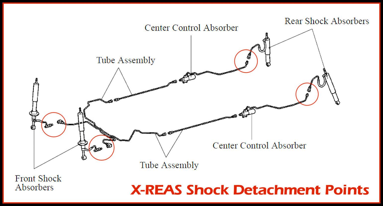

If X-REAS shocks are detached at the system's check valves I've circled in the pilfered picture below, thus preserving hydraulic fluid pressure inside each, can the shocks function temporarily as standard, stand-alone shocks until replacing them with new equipment?
I'll likely be havin' a shop install at least the new front suspension components (aftermarket coils, struts, UCAs, diff drop) later this year, possibly doin' the rear end myself beforehand. Thought I could save myself some labor cost - and make the job more straightforward for the local tire shop guys - if I removed all X-REAS components except for the shocks at home just prior to the job. Then drive it the 15 miles along a winding mountain road to the shop for the install. Given rust concerns, they have the lift and impact equipment to make the front-end job easier and faster than this old arthritic fat man could possibly do here at home. And they can put rubber on the new 17" TRD wheels, pop those on, and do an alignment to seal the deal.
Any concerns about runnin' the stand-alone X-REAS shocks for a short distance to the shop before replacement?

I wouldn't be concerned. Your "shocks" basically control your springs, to dampen them to keep you from going "boing boing" down the road after hitting a bump. When I replaced my xreas system there was NO gas pressure at all in system and I didn't even know it and probably hadn't been since I bought it three years prior. You should be fine, drive sensibly.

Since the XREAS seems to function via the shocks acting a bit like pistons, it's possible that the units themselves aren't vented the way regular shocks are, and that the venting that creates the actual damping might be contained in the linking valves mounted onto the frame rails. If this is the case, you'd have a pretty harsh ride, but if it's a short distance without a lot of bumps it might still be OK.
I have no specific knowledge of the system and wouldn't bet any stakes on being correct about this, but I am a mechanical engineer by profession, and it seems possible given the construction and intended function of the overall system. There's an outside chance that someone in the dealer service department might know with some certainty, but I've also had dealers give me back vehicles with major components not re-installed after some kind of service, so YMMV in that regard.
