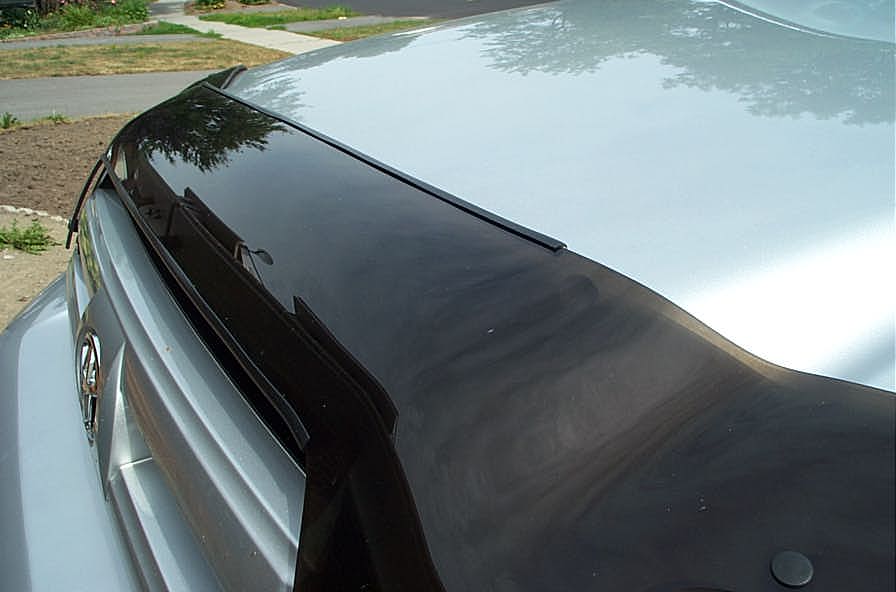

Canadian Bug Shield Mod
Here is a picture or two of my bug shield with the door edge stripping applied to the leading and trailing edge. A picture is worth a 1000 words, they say. Sorry I didn't have pictures earlier. This mod worked for me from the getgo.
GL -TM-
