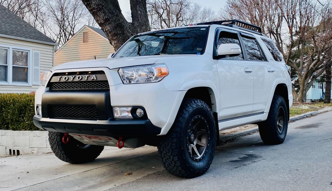

Wanted to do something a little different for the Limited. Swapped out to the Canadian SR5 bumper. Very similar to the trail but no plastic overlay. I also kept the fender trim white to keep the lines clean and mimicked the trail front end. All in all I’m in about $400 as I painted myself. Super happy with the look and don’t think anyone else has done it this way. Next up is to trim the rockers and slap sliders on.

Thanks! I've always loved the OG trail front end as it's a little more aggressive and less chunky. I wanted to keep clean lines so I thought this was a good compromise (plus I don't have to swap out all the fender trim). Once the rockers are trimmed and sliders installed, I think it'll look even better.

Thanks man! In a way this was cheaper than a full trail front end as I didn't need to paint fender trim black, and didn't need the extra plastic pieces. Its a hybrid design of sorts lol. Definitely makes the front more aggressive and the tires more beefy.
I had tried to do this when I had front end damage that required a new front bumper but the part was on 6months back order and my shop couldn't get it. Was it a direct swap or did you have to order extra parts.

Amazon of all places, $130 shipped. Fit is pretty good too.

It’s a ‘12 Limited. I love the new front ends, but didn’t want to do the whole swap as it’s much more expensive with all the extra parts. You can still do a low pro on the OGs, I’m looking at the Victory Blitz bumper myself.
I bought these parts to make this happen, the bumper came from Amazon, and for paint, I started with a white base, then did duplicolor white pearl (070 code), then a few layers of clear. I trimmed my existing fender liners quite a bit with shears (whatever it works lol). The grille is from Toyota Accessories Guy. For the bumper portion (not including grille) I spent about $400 which is really doable.
1. 52112-35150 (fender trim)
2. 52113-35140 (fender trim)
3. 75392-0R010 (fender trim retaining clips x20)
4. 52115-35141 (fender mounting bracket)
5. 52116-35131 (fender mounting bracket)
Great work :-) did you also paint your door handles ?
They are actually plast-dipped. Start with the white plastidip, then top coat with the "pearlizer" plastidip. It looks almost perfect. I got a lot of flack when I first did it, but 10 months later it is still holding up pretty darn well.

Is there a lower lip trim piece that you removed too? I don’t recall seeing any sr5s looking like that up here in Canada.

Oh likely, I removed the lower air dam a long time ago on the stock limited bumper. This is also painted differently from the Canadian SR5 version.
