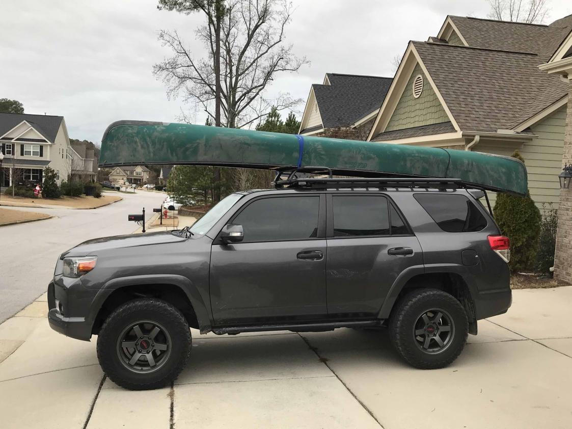

Two cam straps will do it, if they are in the right place. The only time one needs bow and stern lines is if the ropes securing the canoe to the rack can't be placed right up against the gunnels. I took this picture yesterday and had replaced the rear strap with a line due to having left the strap at a friend's house the day before.
Whether using a cam strap or a trucker's hitch (the only right way to tie a canoe to a rack) the trick is to use your weight to pull down as you tighten. In its 22 years, my 17' Old Town Penobscot has probably traveled tens of thousands of miles, including a few cross-country trips on top of the different vehicles secured by only two straps.
You kayak guys are on your own. I don't have a clue about what to do about THAT! ;)
Happy paddling!
