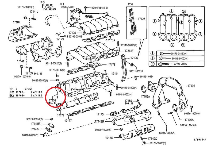

I'm trying to find the part number on the 4 threaded dowels that the intake plenum and plenum gaskets slide over. The number I have is 17159 but nothing comes up when I search it on various Toyota parts sites.
The parts guy at a local dealer assured me he knew what I was talking about then ordered the wrong parts.
Correct me if I'm wrong but I'm pretty sure all 4 are the same part #.
It's worth noting the the 2 bolts pictured have "No. 1" and "No. 2" next to them and that usually indicates that they are/can be different individual numbers.
He's right. The 17159 is NOT a part number, it's just an index on the illustration to tie to the parts listing, which follows:
17159 BOLT, STUD(FOR MANIFOLD TO CYLINDER HEAD)
90116-08251 NO.1 4
90116-10150 NO.2 12
The 4 and 12 are the quantities of each used.
The No. 1 is the intake manifold and No.2 is the exhaust manifold so 90116-08251 is indeed correct.
How your dealer could screw up looking at this listing is a mystery to me.
