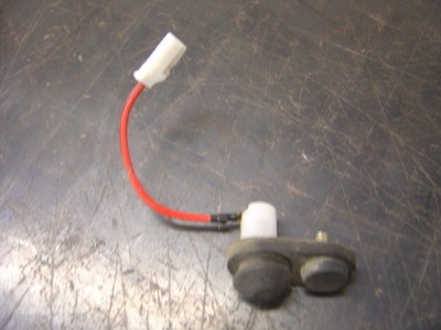

- when i open the driver door the door light doesn't come on but when i open all the other doors, door light comes on.

2. Your door position switch in the driver's doorjamb is broken. Take off the rubber boot, there's one bolt and pull out the switch to disconnect and then put a new one in (don't lose the wire connector in the pillar though!). Can be bought secondhand off Ebay or a junkyard for very cheap. Basically your 4Runner thinks the door is always closed since it's not grounding when open.
