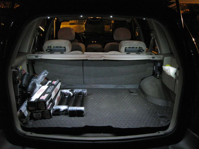

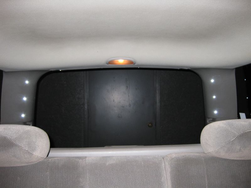

Stumbled across this thread and reminded me of the following thread (when I was an active member on jeepsunlimited.com forum):
Cargo lights WJ - JeepsUnlimited.com Forums
This wasn't my Jeep, but I also thought this light mod would be useful. I got rid of my Jeep almost a year ago. Anyway, here's an idea for ya. :cool:
Ed

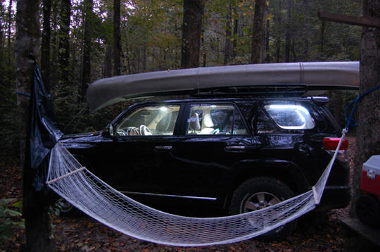

LED Cargo area light strips!
Yes I have done it! I bought LED strips from Autozone. The only thing I have not done is wire it correctly to the rear cargo lights. Right now they are wired to the dome light over the second row. So, they come on when I open the front and second row doors, or when I use the switch on that dome light, but NOT when I open the rear lift gate. That is a problem because I have to leave one of the four front doors open for it to stay on for more than 20 or 30 seconds. I plan on changing the wiring to the lift gate soon, but it still looks the same. I need to take more pics. The other thread has some info on it about this too. First impressions:
1. They are frekin REAL bright, since I have two strips on each side.
2. It is now really nice to see everything back there, and the difference is massive! I now can't stand the thought of not having that extra light.
3. They are stuck to the rear pillars, so things won't hit them that often, and it sheds light in the same direction as I am looking when I am loading and unloading things.
4. Beats the heck out of cutting holes in your headliner.
5. The wires are only exposed a very tiny bit since I ran them right into the panel behind the little panel door where you access the tail lights.
6. People who notice them are blown away by how nice the light is. Some also think that my t4r is a limo (not good IMO). (another reason I would like to have them only come on with the rear lift gate, which they will soon!)
Here is the only pic I have:
