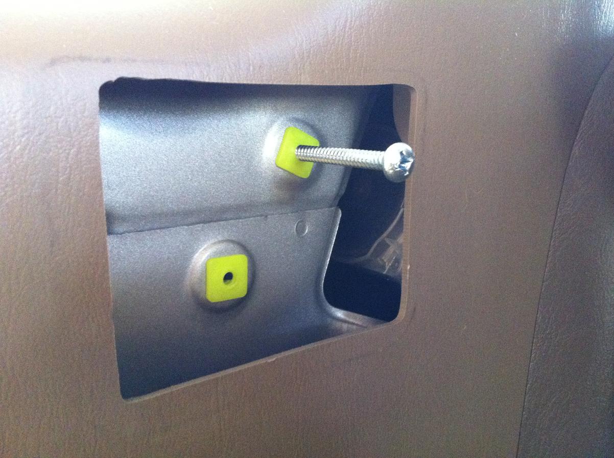

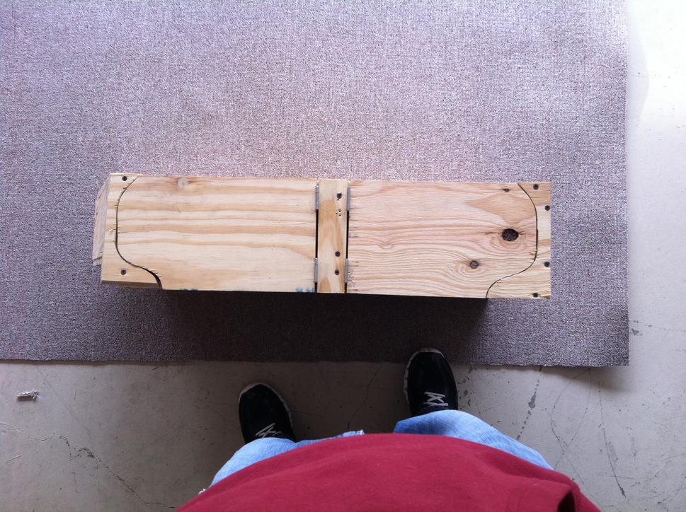

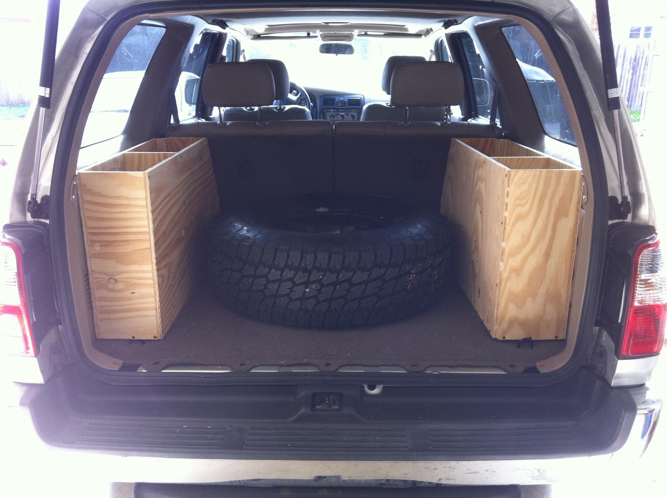

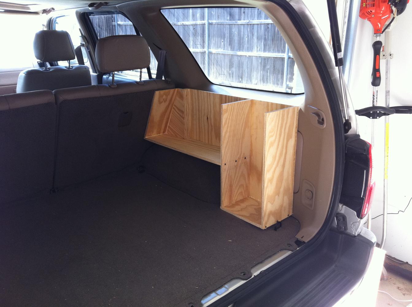

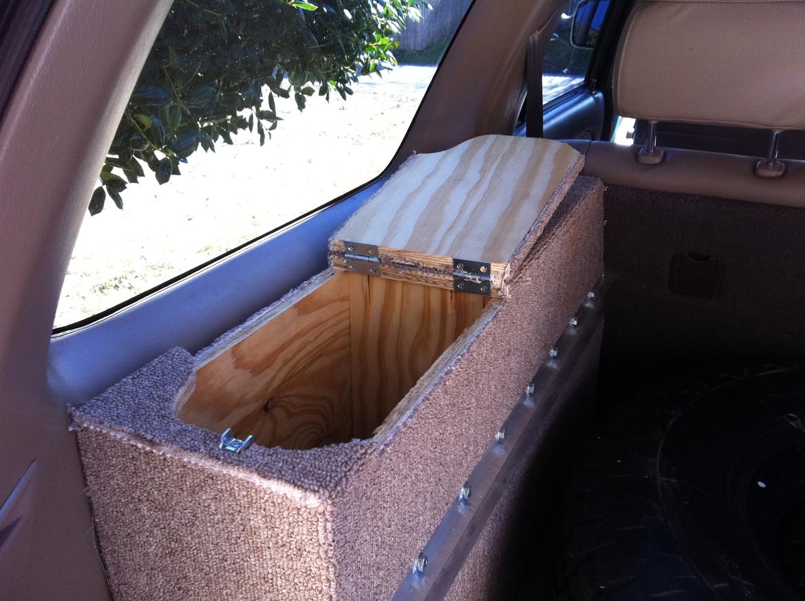

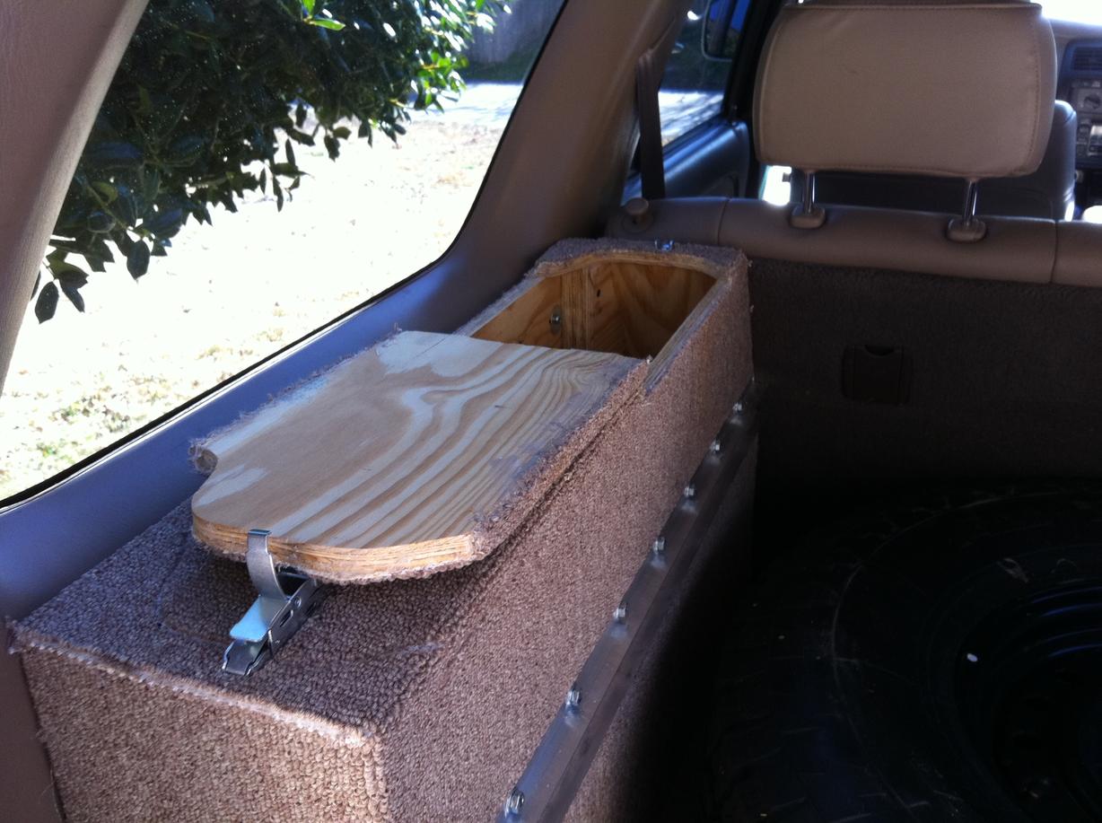

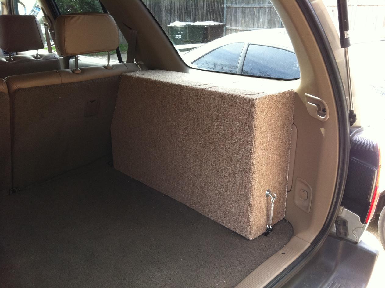

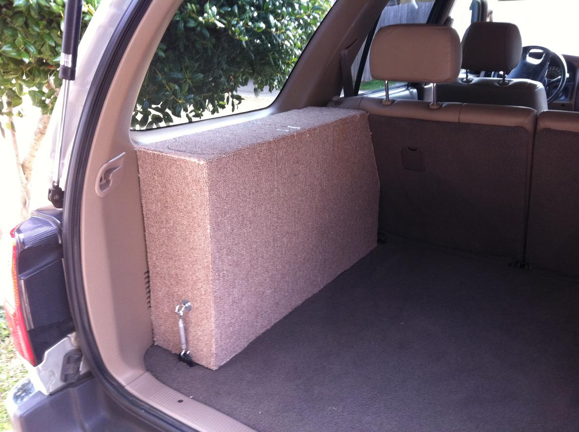

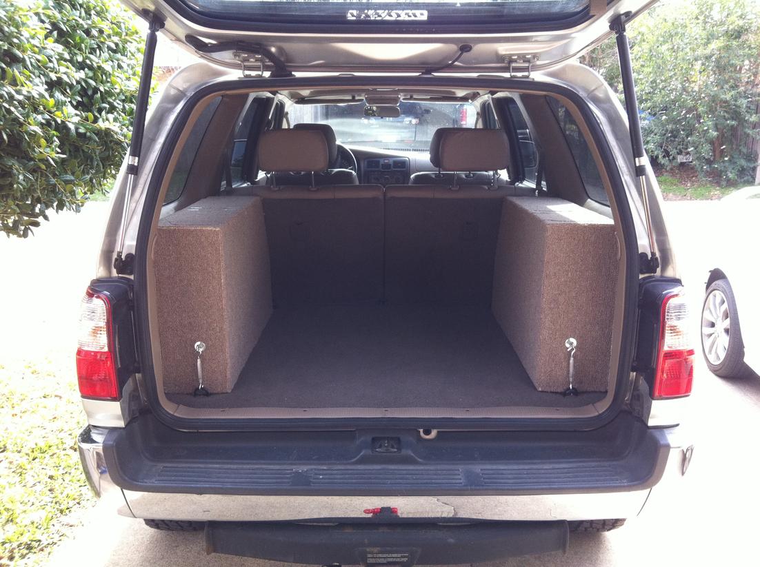

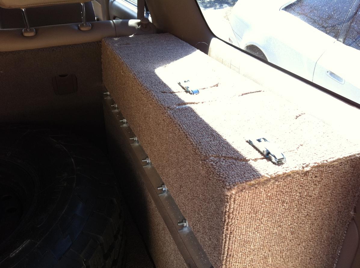

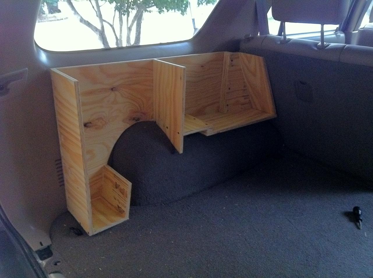

Started with the boxes:

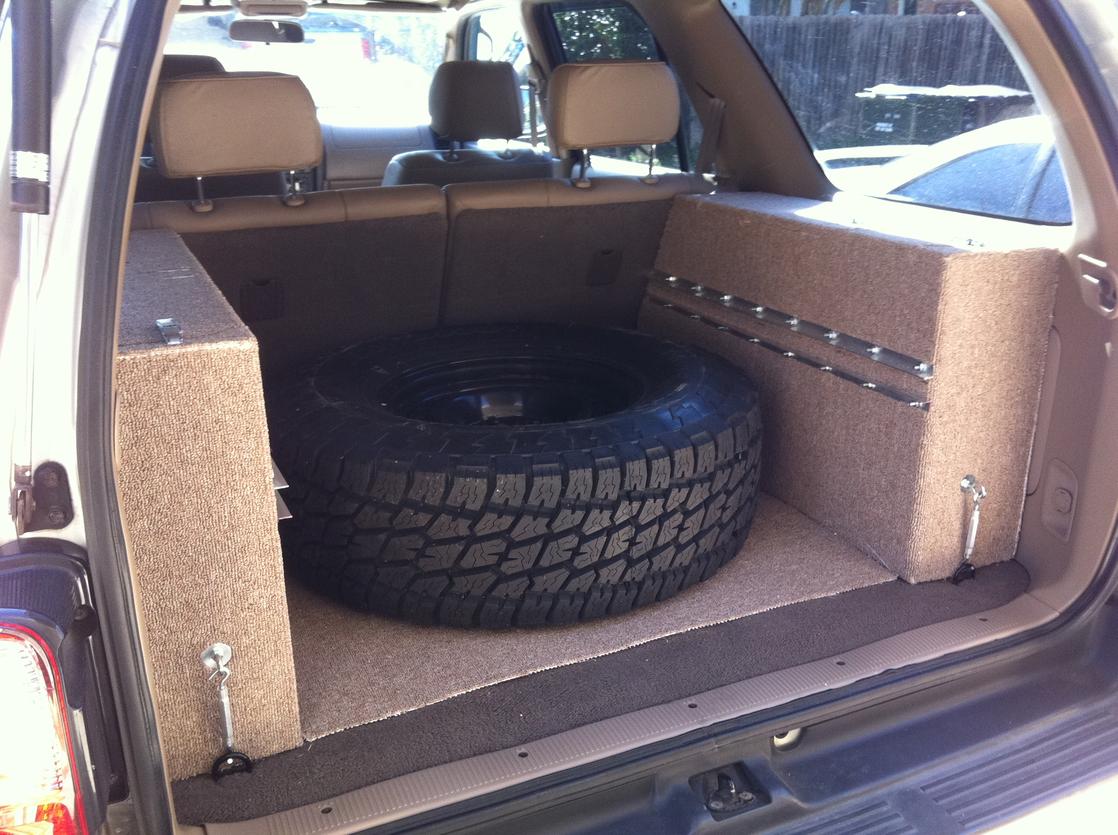

With Spare Tire:
Using the tonneao cover as BigFish utilized:
Wrapped up both in Indoor/Outdoor Carpet:

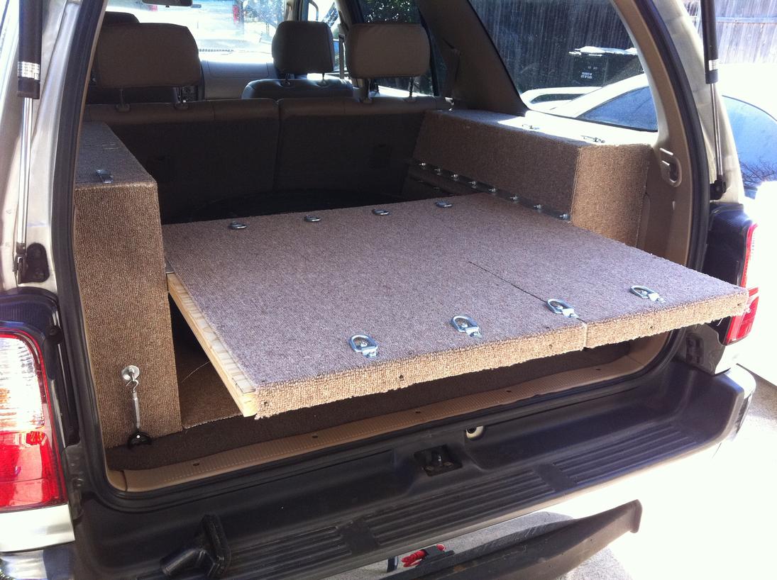

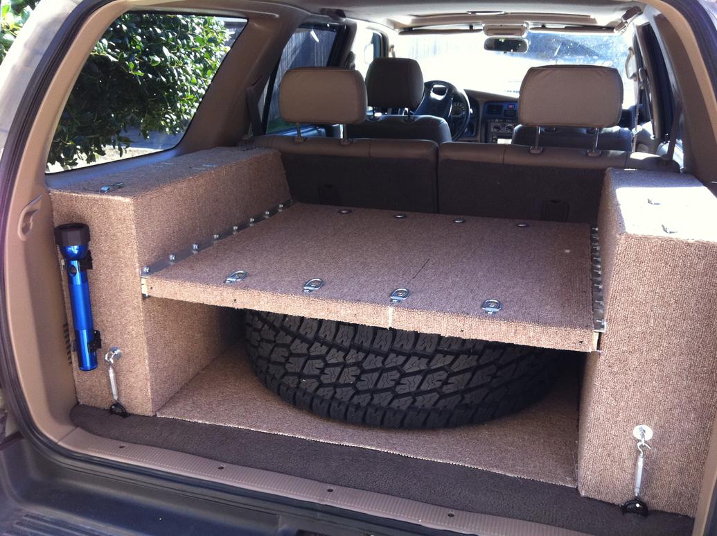

Next came the removable deck.

Excellent work, with emphasis on the removable deck. Added inspiration for me to finish my cargo box, so thank you!
any idea how much weight it adds? I've had a lot of ideas for my own build, but haven't had the chance to do anything with it. I do like the better use of space around the wheel wells though. My fridge has made that area extra useless.
My best guess would be the boxes and deck add in the 35 to 40 lb range. used 1 1/2 sheets of 1/2 ply. The wheel wells are a wasted amount of space......
Looks good, I like the creativity that went into the shelf and spare!
Thanks man, had a few different ideas on how to accomplish it, this one just seemed to be what I could fab, instead of having something welded up.
thats my favorite idea for a cargo box. nice, simple and removable lol
Couldnt have said it better myself.......Thanks!
Looks great!
One thing though.. If you are intentionally covering up the cargo compartment on the passenger side, why not incorporate it into that passenger side box?
Looks great!
Thanks Ripcord. To tell you the truth I really couldn't figure out a way to incorporate it functionally and not just be awkward space. Didnt want to perminatly alter the vehicle to make that happen either. Not saying it cant be done......
Nice job! Cheap, effective, and makes good use of the space you have.
I'll be doing something similar, but for stereo equipment on the passenger side. I will be utilizing the stock cargo compartment for extra air space for the sub. There's about 1/2 a cubic foot there if you take out the black plastic tub.
Anyway...good job!
That was weird looking at the pictures of the driver's side box, it was like watching mine get built all over again.
Good work though, I like the additions you made to the design. The removable deck is pretty sweet. I had to leave that space open on mine because my dogs ride there. It was also a good idea using turnbuckles to secure the rear of the boxes... that would make it easier to remove than using a bolt & L-bracket. I'm going to see if that will work on mine, but my flashlight & fire extinguisher might get in the way.
Last but not least, thanks for giving credit where it was due, and not just biting the style. :cheers:
Nice. I like how it uses the dead space over the wheel wells.
The boxes look like they are fastened down well. The deck also looks pretty stout. Please make sure that things don't become projectiles if you hit your brakes hard, or worse.
