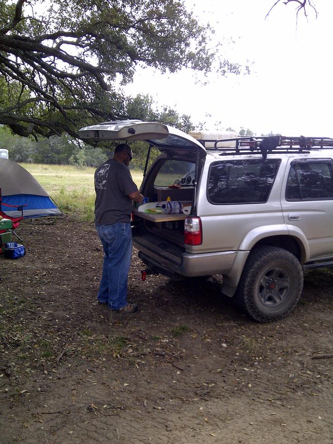

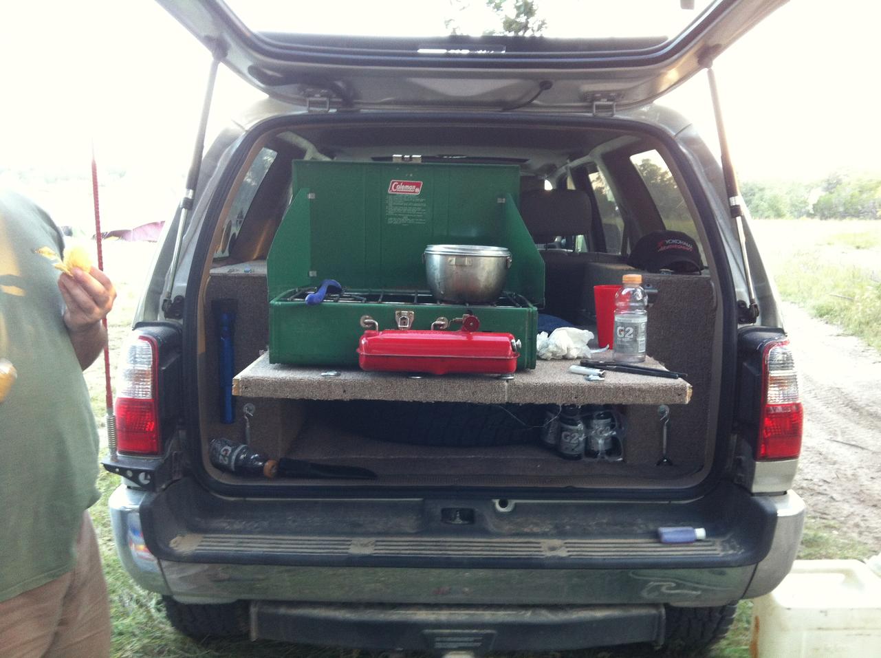

Man I love this thing......i have ended up cooking on it numberous times, figured id get a picture. Just pull out the deck half way, roll down the rear window, and you've got yourself a great sturdy work table or cook table.
