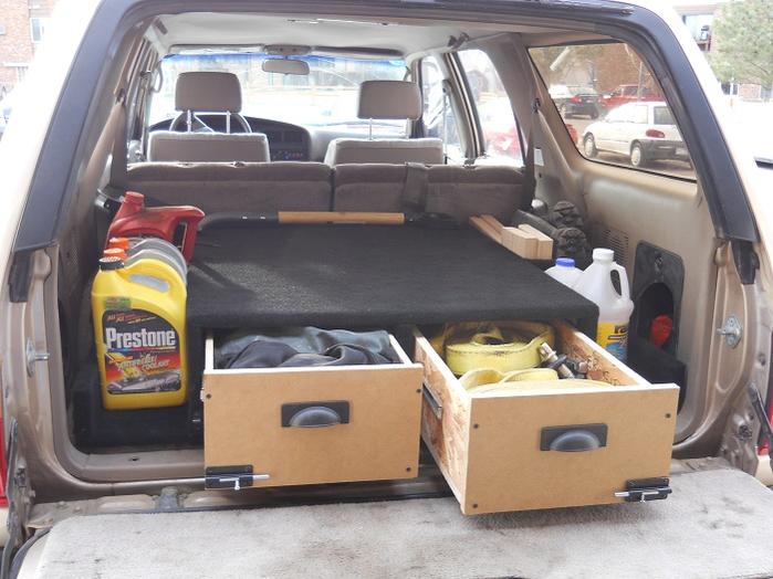

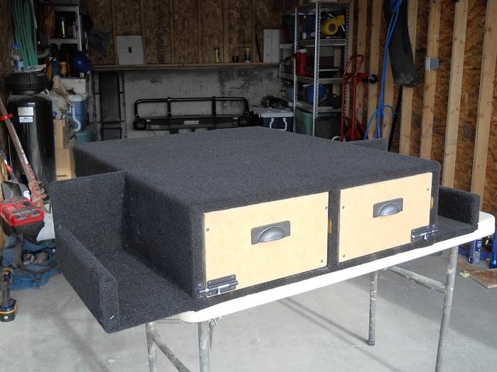

Here's another possibility, something I threw together. The drawers have 100-lb. rated slides, so they can haul the goods and still open easily. I found I need to go with heavier-duty hardware for the locks, though--since using it, the bouncing on trails caused them both to tear off (although they have the tailgate directly behind them, so they can't open far).

awesome man that is pretty cool. I think im gunna go with one over the wheel well cuz i tailgate A LOT and i also dont wanna sacrifice cargo room
