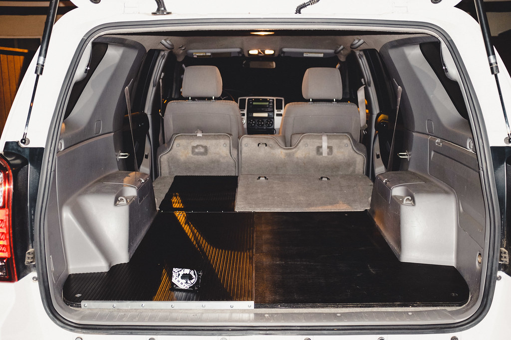

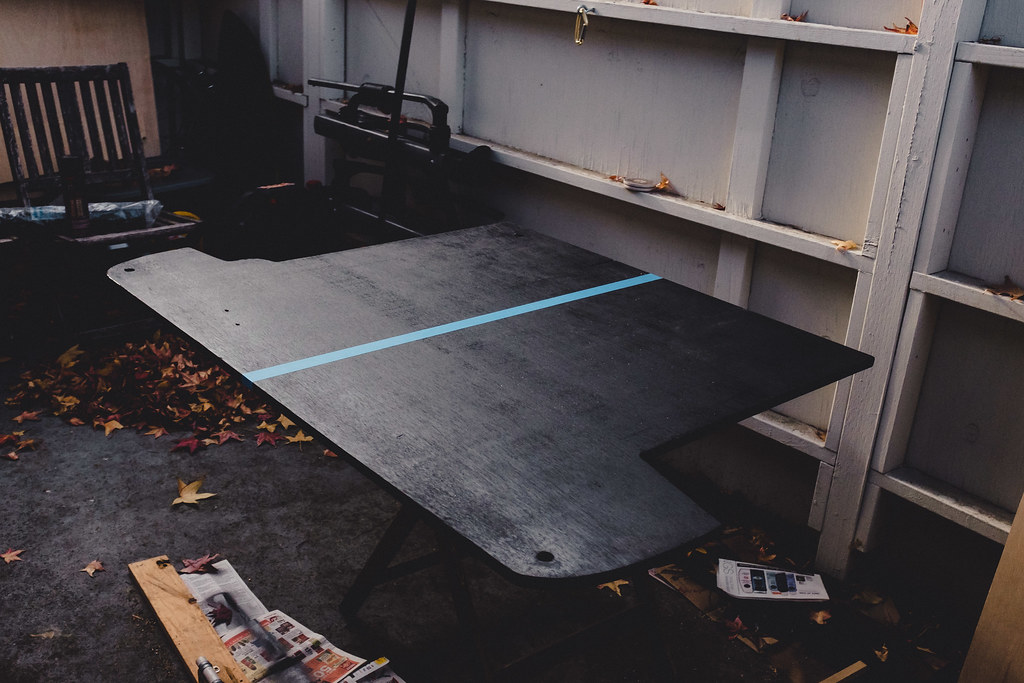

Started off with a base. Lots of cardboard templates. I used 3/4" ply.

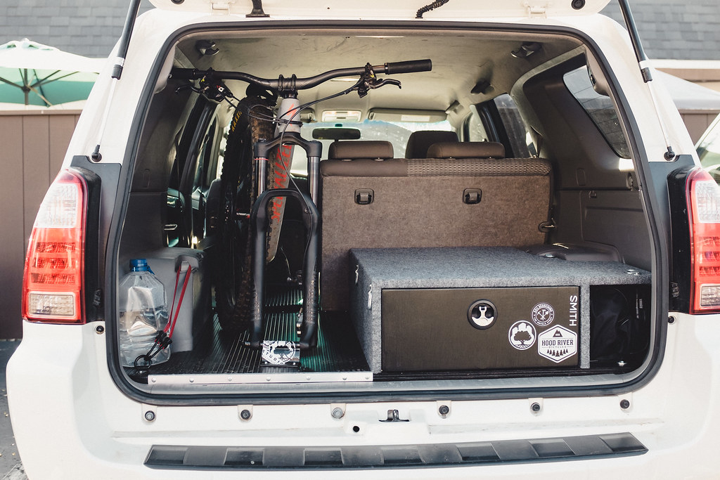

Half of the area is for bike storage or other things such as a cooler.

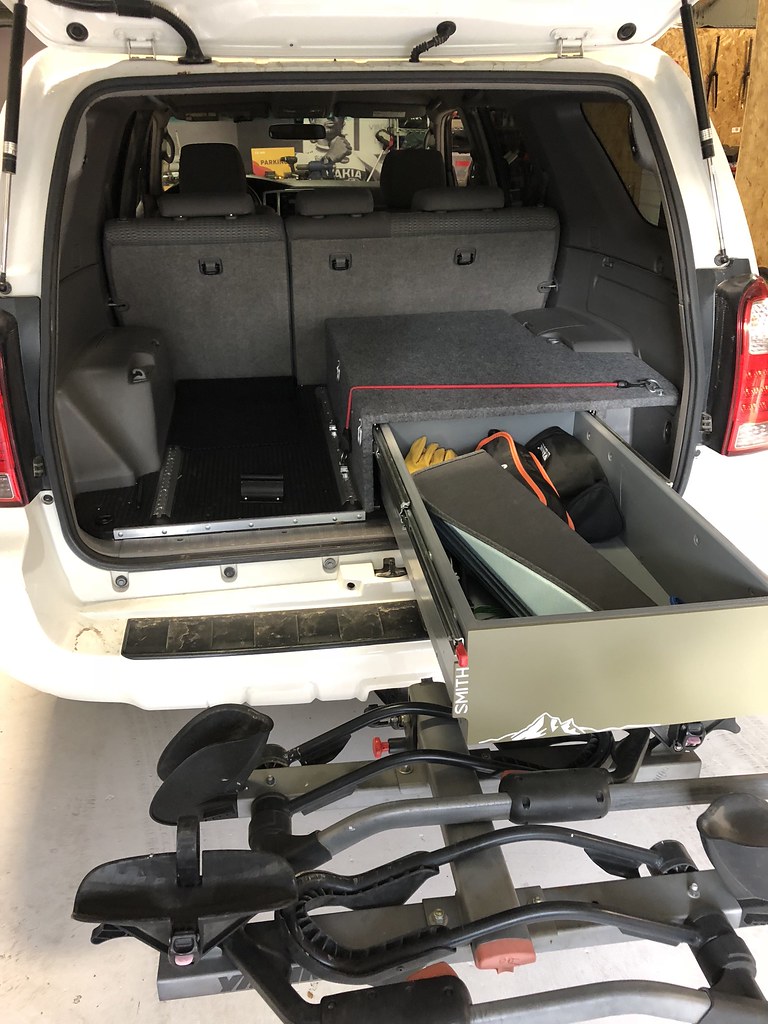

This is what I got from version one. It was a basic drawer that worked. Nothing special. The drawer housing is good, but the drawer itself was a bit flimsy.
After using the version one setup for a while, I saw some places for improvement, especially after I saw my buddies setup with a pullout stove. So, back the the drawing board. I liked the base plate, and the cubby size, so it was just a matter of remaking the drawer. I also wanted a way to hold the stove.

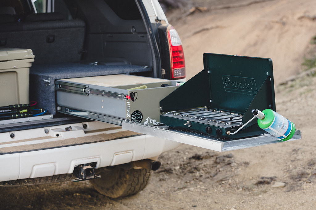

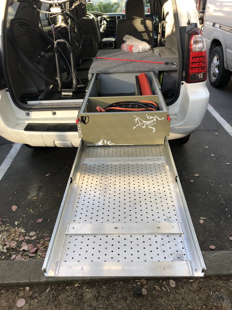

Here you can see the new drawer. Pretty basic. I used 3/4" ply for the bottom, front, and back. The sides are 1/2" ply, with an additional piece of 1/4" ply laminated to the top half. The reason for this is to create enough room on the sides towards the bottom for the stove platform.

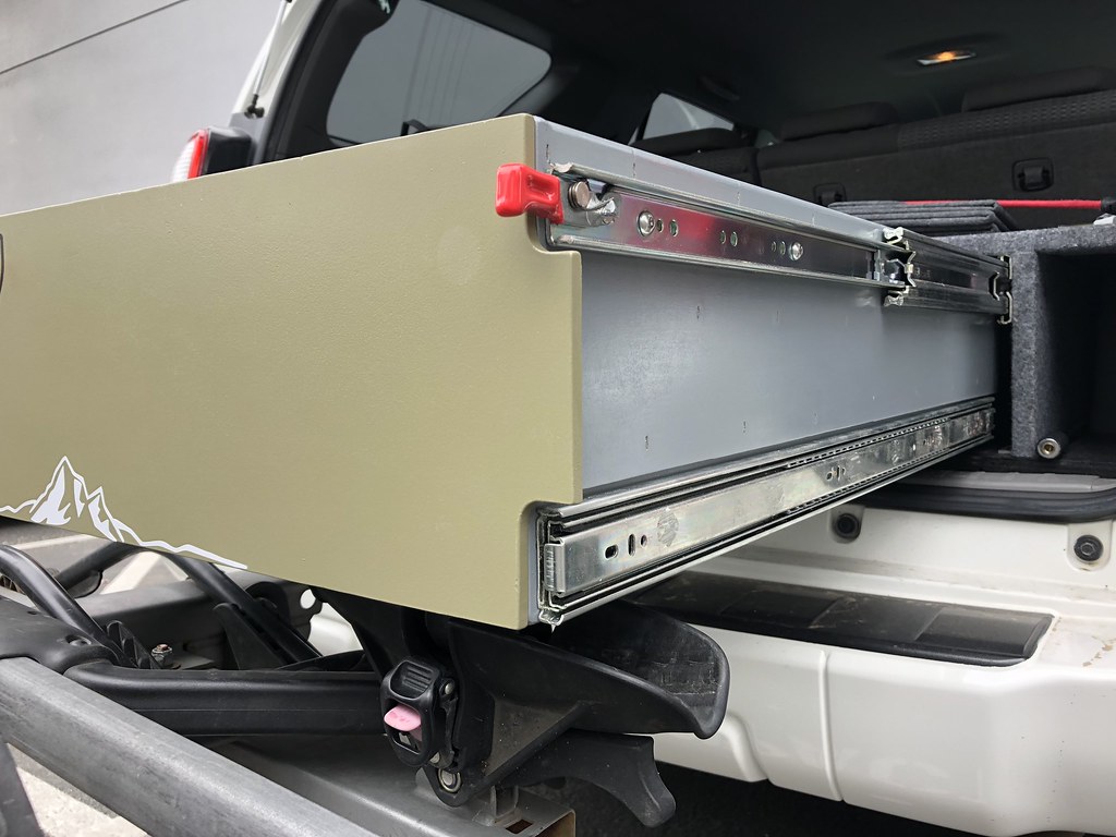

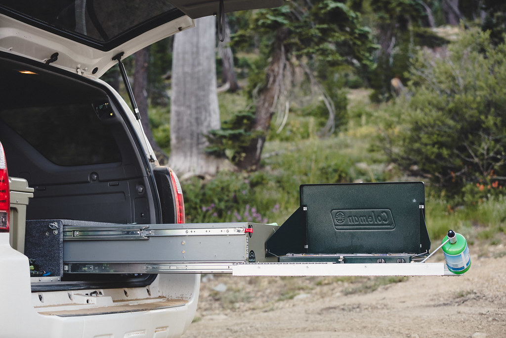

I got heavy duty slides that lock in both open and closed position. This is another thing I learned from version one when I parked on a hill. You can also see the stove platform sides, and why I needed the extra clearance.

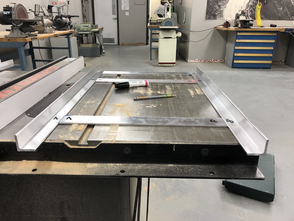

Stove platform

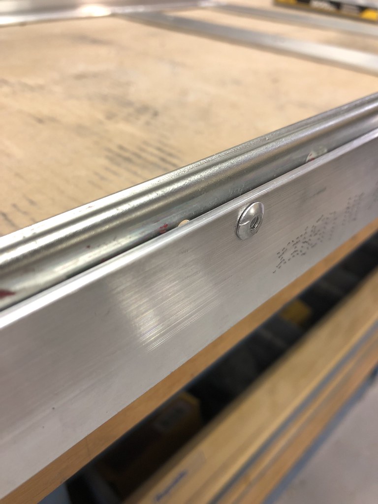

Rivets to attach the slides to the platform
All mounted up

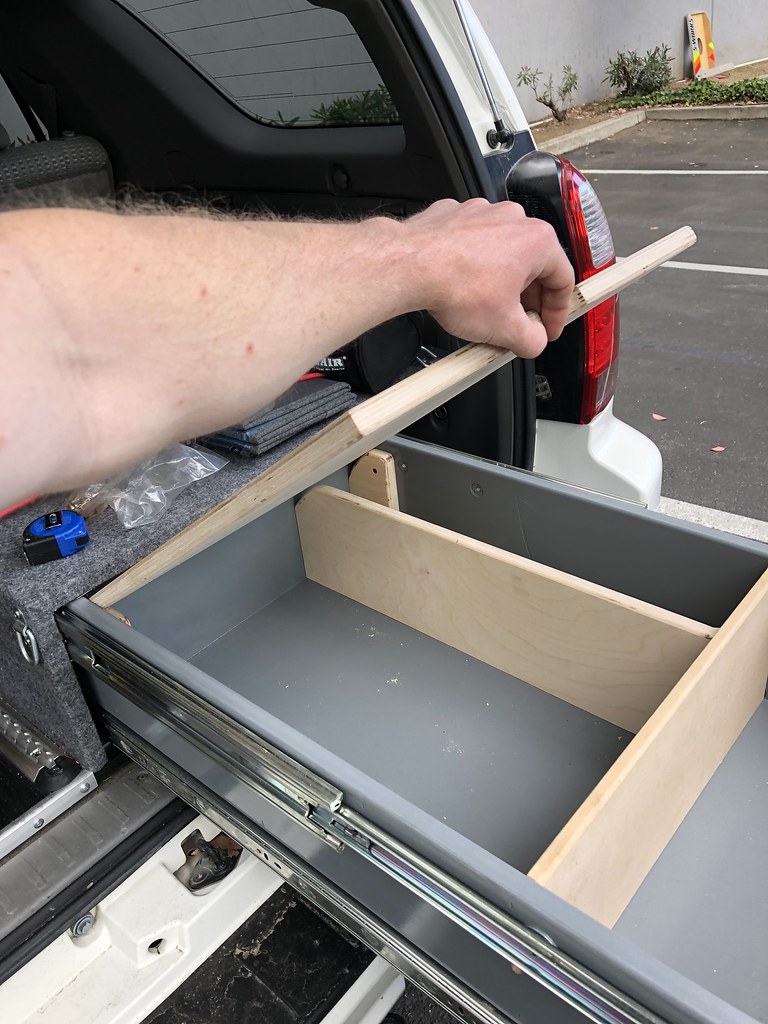

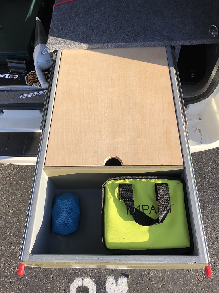

Mocking up the storage inside the drawer
And a top lid that acts as a counter-space for dinner prep
And lastly a couple spring loaded pins that lock the platform open and closed
And the finished product!

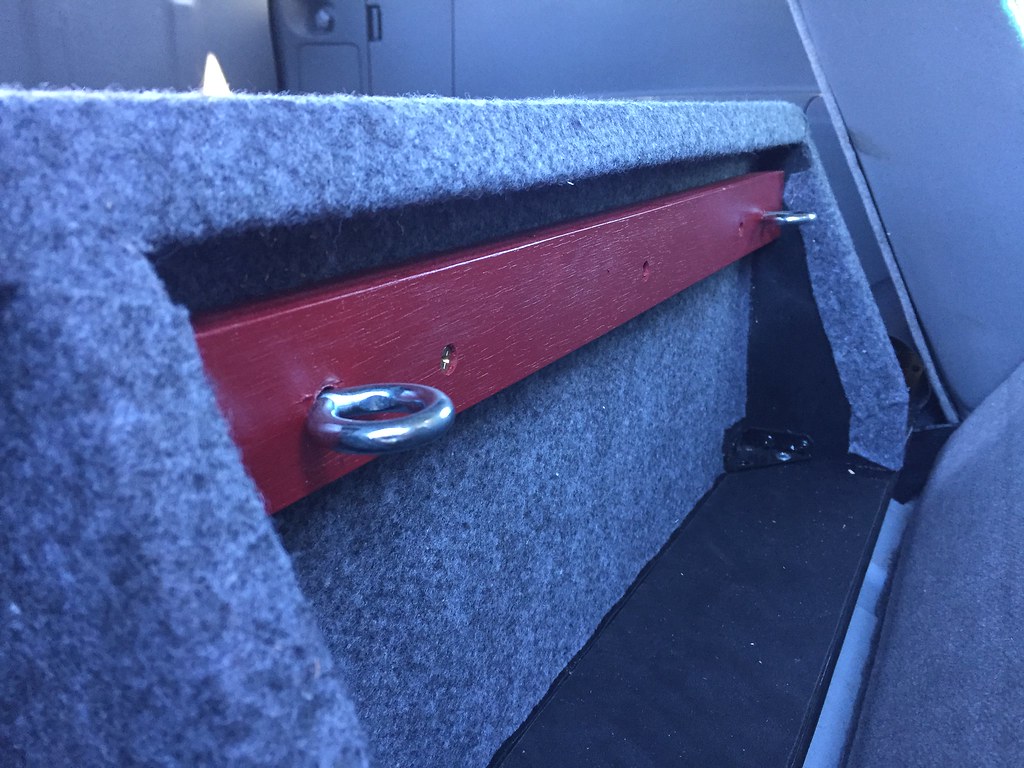

3. There are 4 tie-down points in the factory cargo area w/ d-rings. I pulled those out and got longer bolts.

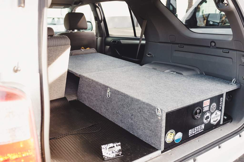

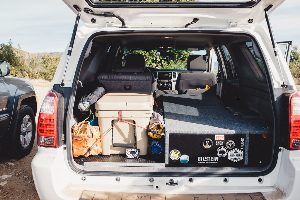

4. Here is the sleeping platform. It's a removable leaf that extends forward. in the front, it's supported by 1.5" dowels that go down to the floor.
The leaf has a lip that slides in and rests on top of the red piece of wood, and then is held secure by turnbuckles - so when tightened, it gets pulled into the back of the drawer box, making it very secure. I also have a platform that extends over to the other side so my wife and I can both sleep in there, but lately we've just been using a tent if it's the two of us so we have more space.

Sorry, should have been more clear. How are you securing the drawer to the plate? It looks like it is just resting in there. I did the same with my cargo plate and extended the bolts in all 4 corners. This was a mockup at the time, but fridge lives on driver side now.
Oh, it's just glued and screwed from the bottom. Makes it real fun trying to get out... but it fits, kind of.
