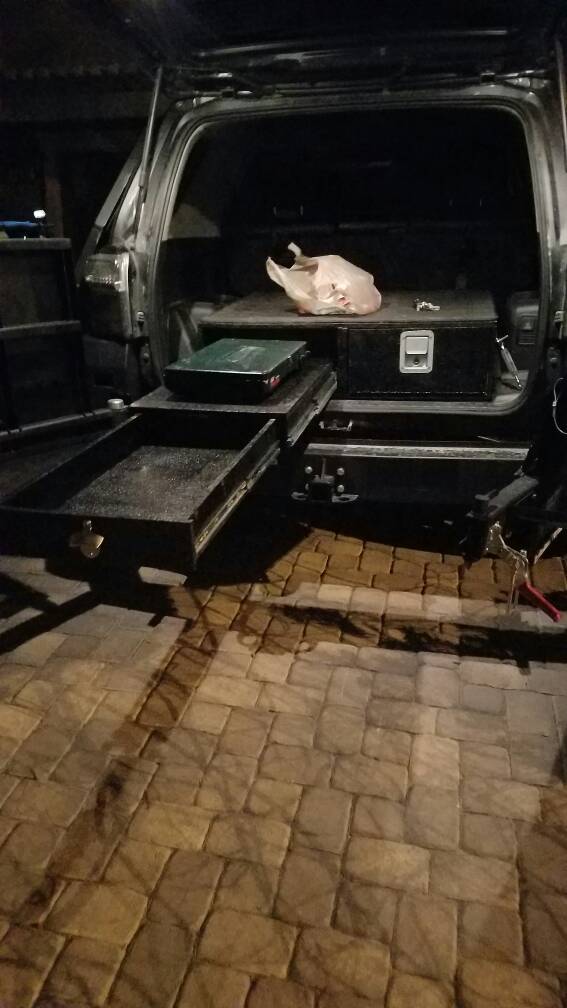

I used bs1088 marine grade plywood.
Not the prettiest, but it works! Haha, thanks for the inspiration and info on rails [emoji16]

Looks great! I'm getting closer to getting started. All parts are ordered and should be showing up over the next few weeks. I've been trying to figure out how to make my drawers slide in and out with minimal time required. On my way home from work today it hit me. I'll still use 2 turnbuckles per drawer on the forward tie downs behind the rear seat to eliminate rearward movement and keep it locked until I want to remove them.

I'm not really understanding how the drawer drops in then slides forward to lock. If we are looking at the underside of the base and the base is attached to the metal floor, not sure if there will be enough room for the flat piece to slide forward and lock in.
It's hard to see on the 2D .gif, but the wood is inlet so the metal bracketry is inset and flush. A little router work, no big deal.
