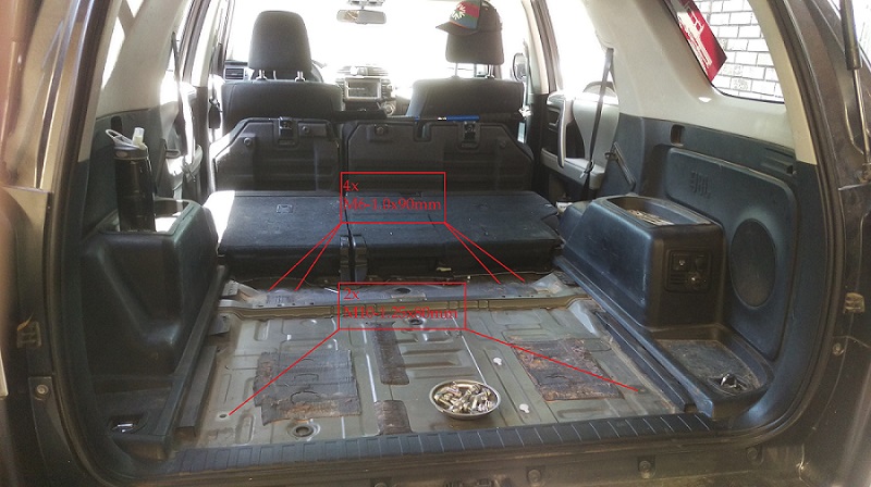

Not sure if you had the factory cargo tray or not, or if the holes are different, but I removed mine for my build. I then used the factory cargo tray mounting holes to secure the base of my cabinets, so it's fully bolted in.
The front (against the back seats) used 4 M6-1.0x90mm bolts
and the rear used 2 M10-1.25x80mm bolts. Just measured carefully and elongated the holes to allow for some misalignment. I'll try to get some pictures, but it came out super clean.

I don't have a picture of the actual bolts through the base, but here is a picture of the mounting points I used. I didn't drill any holes, just cut a piece of 3/4 to fit the entire tray area and used the factory threaded holes. I had the factory cargo tray though, and I have two threaded holes in the back that I don't see in the picture from the link you posted.

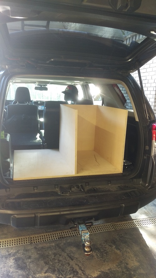

sorry for the terrible pictures but its all i have right now.
cutting boards are 1/2
sink section is 36
stove section is 28
utensil section is 28
