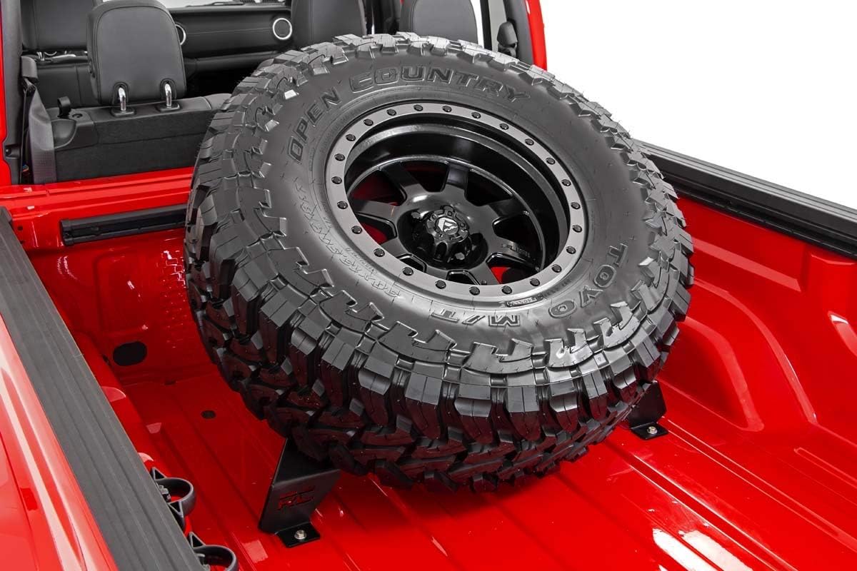

Not really into wrestling with a swing arm to get into my truck. Not really interested in spending 3+ g's for a swing out. Not really interested in adding all the weight. Not really interested in moving my reverse camera. Not really interested in worrying about theft. Not really interested in making my truck longer.
Will compromise on a bumper if convinced otherwise.
My thoughts:
Floor plate in the cargo area. Vertical tire mount... mounted to the floor plate and body floor like the do in the 80 series.
Forums are spotty and people mumble about doing it but my search yields nothing.
Anyone have some input?
Interior Tire Carriers - Land Cruiser Products - LCP
image-jpg.1015193

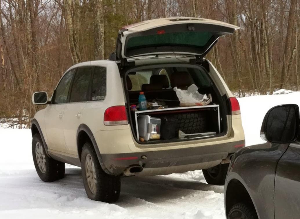

I had my (oversized) spare stored in the cargo area in my Touareg, and while it did occupy a ton of space, it worked.
The Touareg wasn't able to have it vertically like the 4Runner can, so it had to lay across the cargo area, thus I built a box around it. The box was held down from all four sides, and subsequently held the tire in place.
With all that being said, I'm glad I never had to switch to the spare as I'm sure it would have turned the cargo area into a dirt/mud disaster (come on, you never end up needing a spare in clean dry conditions)
Thought about going this route as well. Still on the table for sure.
Dirty interior in the off chance I have to use my spare isn't the end of the world for me. Although with the box setup it would be much worse the vertical.
