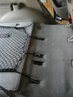

Here is what I did. I got 5 med small snaplinks from Wally world. They were some kind of PGA brand i think and of course the Spidernet form the Stealership.
I first put 2 links on the cargo "D" rings at the entrance to the cargo area.

Then I placed 3 links on the net and placed them here , where the seats lock in to the floor.
There is one leg on the drivers side of the back seat. Hence no snaplink. I just slipped the net on the rubberstopper leg and closed the seat down to the floor..

Here is a view with the third row installed.
Overall, I am happy with this mod. My stuff stays put now. Hope some of you can use this.
