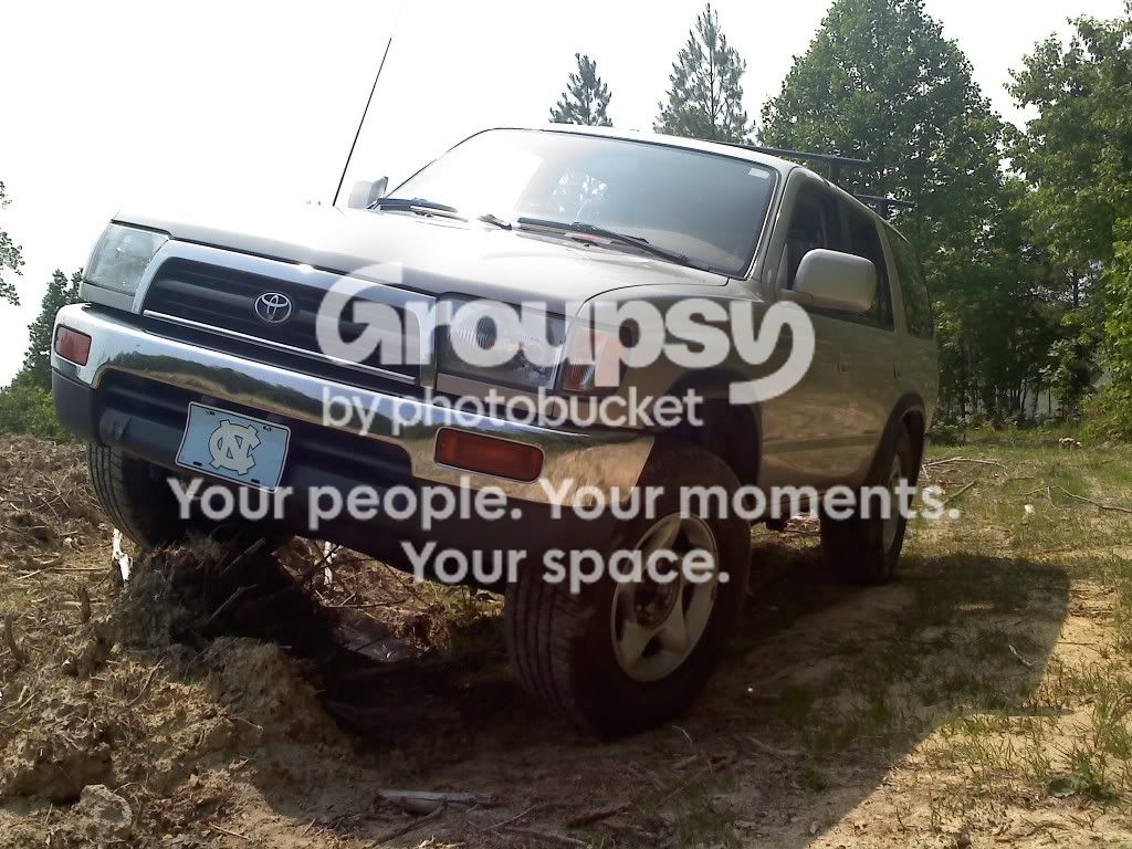

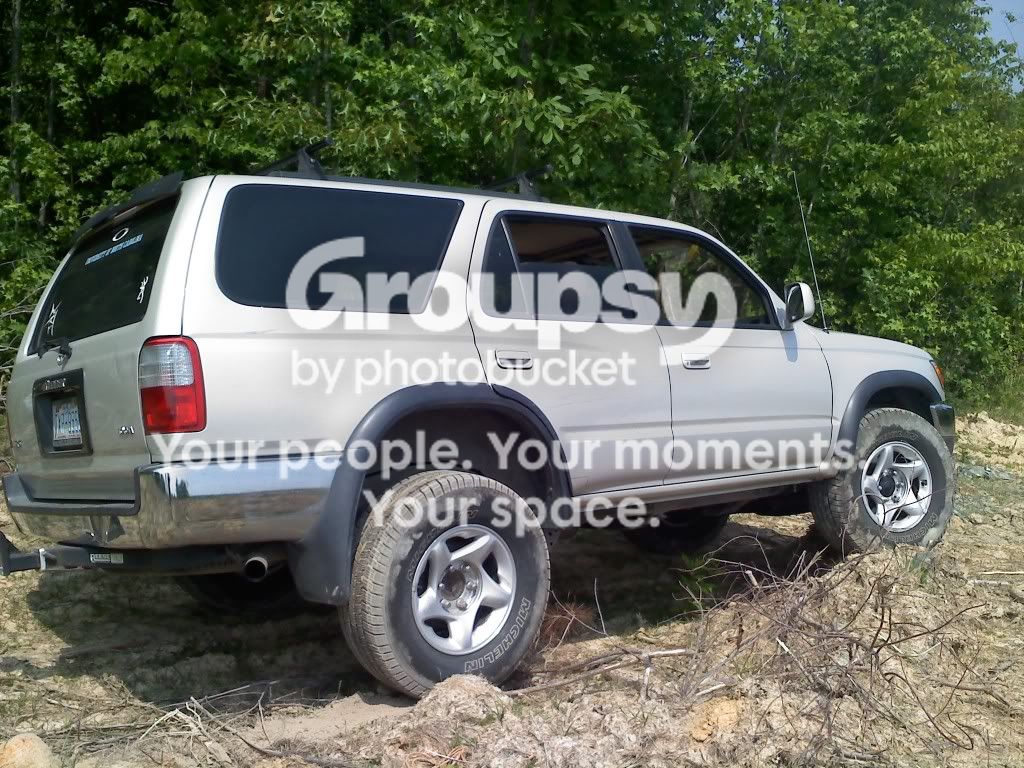

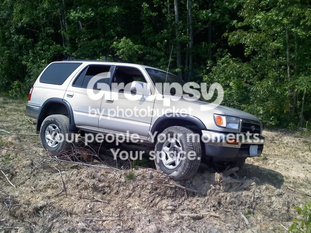

Stock Suspension Wheeling after work today...
StockWheeling.jpg~original
StockWheeling1.jpg~original
StockWheeling2.jpg~original

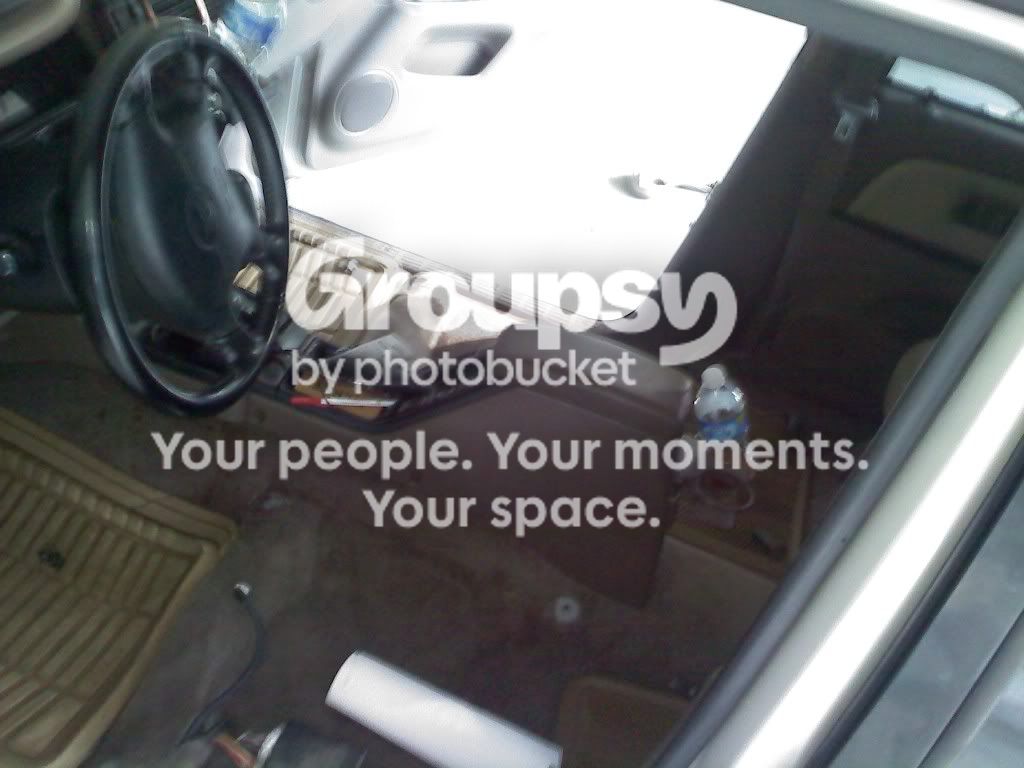

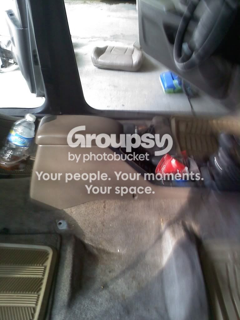

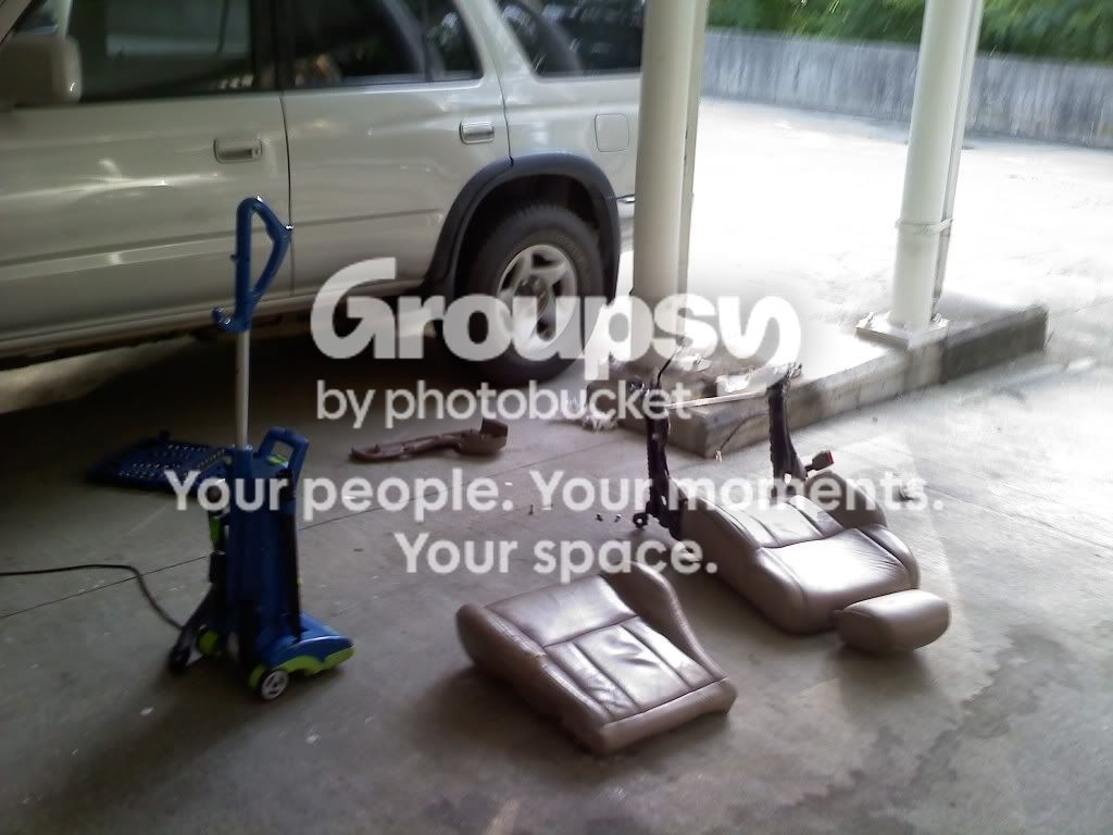

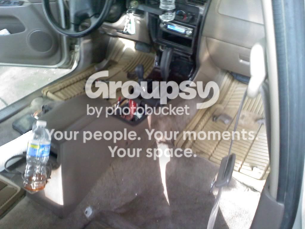

So today I finally decided to switch out the front leather cushions since the left side of the driver seat was wearing out and cracking pretty bad just from getting in and out. I know it's not really a mod but I haven't done anything to my truck since I got it really so just figured I'd document everything. If anybody wants to know more about what I did it was really simple, just let me know. The only condition is that you must make sure that the passenger seat does not have a weight sensor which turns on the passenger seat belt light. Everything else is easily interchangeable. Also, apologies for the fuzzy cell phone pics.

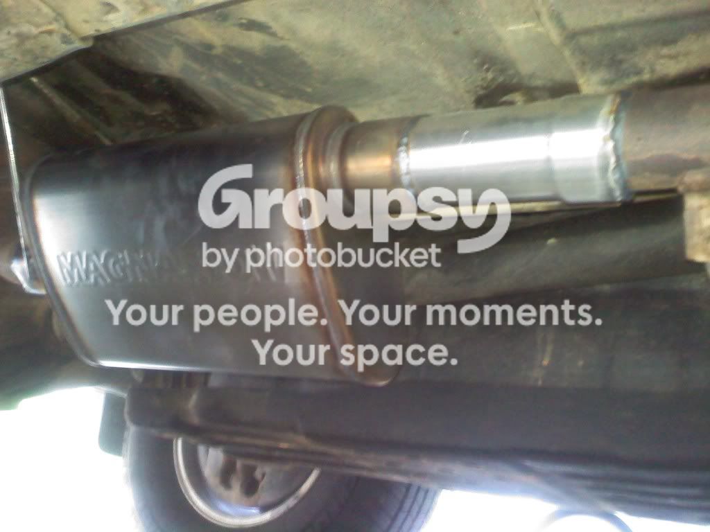

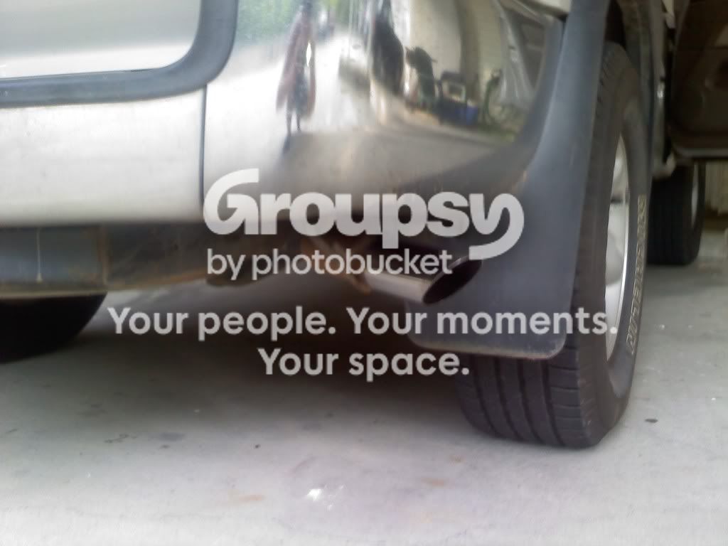

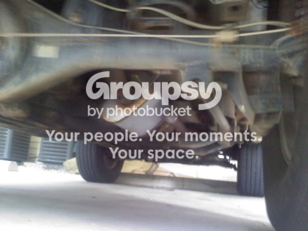

I got the Magnaflow 14" & chrome angle cut exhaust tip put on today at Henry's. I'm not too sure about your friends experience at Henry's but they were very up front with me about everything. I checked the welds and everything was done well. They even alerted me to a slight rattle in my cat converter and did the proper checks to ensure that it didn't need to be replaced... all at no cost for the diagnosis. The exhaust sounds great though and I'm interested to see how it breaks in over the next few days. I'll post pictures sometime tomorrow afternoon. Like most people say... I was surprised at just how big the stock muffler was when they pulled it out. It's about 2 feet in length.
Why is the muffler tilted at that angle?
Since it's a offset in/center out that's just the way the muffler sits because of its smaller size compared to stock. The stock one sat level but since this is a universal muffler they just have to line up the in/out. It actually has better clearance than my stock muffler too, even though it doesn't look like it would because it's angled.

It shouldn't be titled like that. My Cherrybomb is center in offset out, but sits level. It's not a huge deal, but they probably got lazy.
It may just be the piping specific to my truck then. Because the offset in pipe is set above and to the passenger side of the center out pipe. So unless they had bent some piping (which could have changed the need for offset in/center out all together), this is the way it was going to sit.
It just looks like you wanted "Magnaflow" to show if you look under the truck, which is fine. Happy driving. I ended up shelling my Magnaflow because it was too loud in tandem with my K&N.
