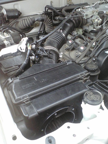

ISR mod... done the weekend after July 4th. Just now getting around to posting it up. Not very exciting but if all goes to plan the lift will be ordered in less than a month!
I "tested" the deckplate mod by leaving the flip top open for a day before deciding to do that one but with this mod I just went for it. Not really reversible once you reroute the air tube into the T-joint. It sounds good though, notice a slight power increase and helps out the exhaust tone a bit too.
From above...
ISR_mod.jpg~original
From the front...
ISRmod.jpg~original
