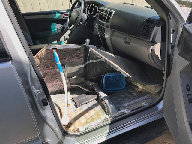

The channel holds the rear washer hose on the passenger side. If that isn't protected you end up where I began the whole replacement process, with a gallon of washer fluid absorbed in the carpet pad.

you will need to remove that black plastic piece for the new carpet. I have done this before. Its great to get that old dirty carpet out. Will you be adding sound deadening material. I can also say that Im done with carpet and I just ordered the vinyl replacement from stockinteriors for my current 4th gen. Its black and I will never have to deal with shitty carpet again! I should have it next week.

you can use a staple gun to attach the plastic but it really does not need attaching just there to hold up the carpet a bit. FOr sound deadening buy some fatmat or dynamat. and some rubber vinyl
