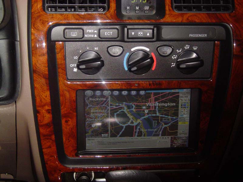

7" Lilliput TS Monitor (installed where the radio used to be...looks almost like factory)

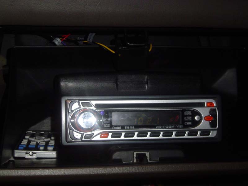

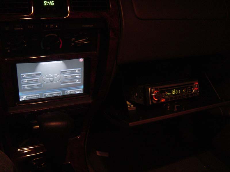

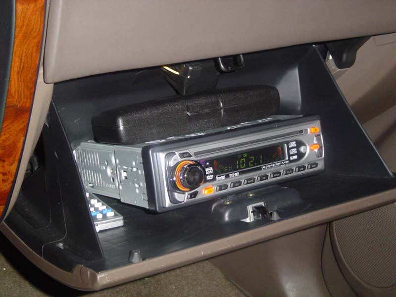

Farenheit DVD Head Unit (installed in the glove box)

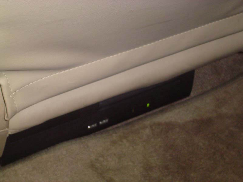

Carputer (underneath driver seat)
- Casetronic 2688R
- Via Epia V800
- M1-ATX 90W PSU
- 20GB 3.5 HDD
- DVD ROM

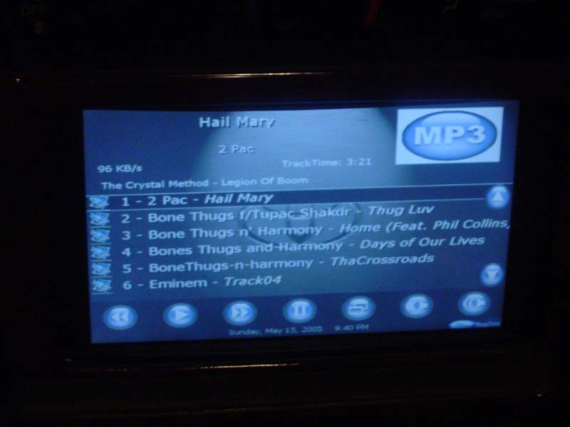

- Media Engine as Front End

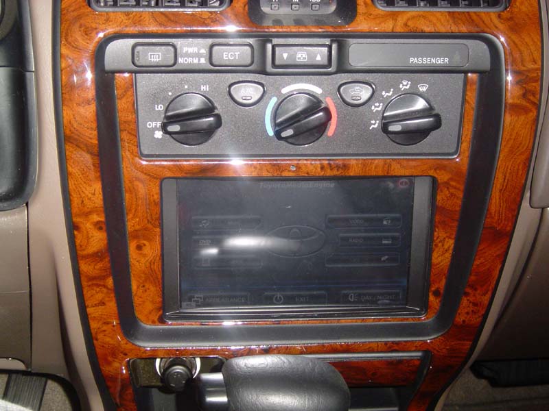

I finally took pictures of the carputer. The pictures are not that great since I took it at night. Let me know what you think.

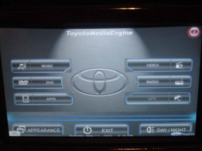

This is one of the touchscreen.

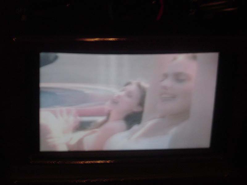

Music video playing. The image sux cuz I didn't pause the video before I took the picture. Oh wellz...

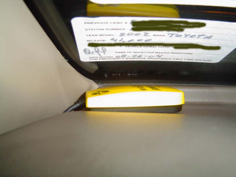

GPS unit located on the dash by my inspection sticker. It picks up satellites within seconds there.

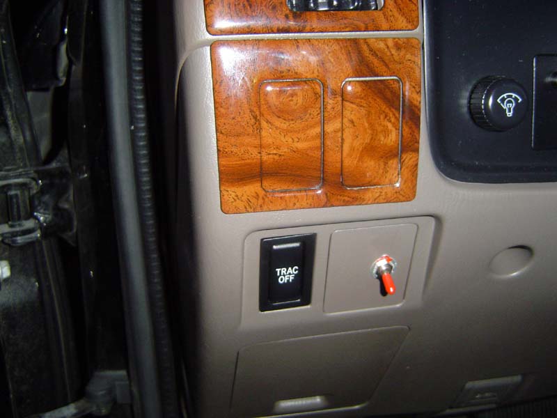

A switch I put in to keep the computer off when I don't need it (i.e. when I listen to the radio or playing a dvd on my head unit).
