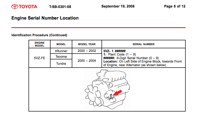

How/where can I check the engine # and match it to the VIN#?

Just found this:
