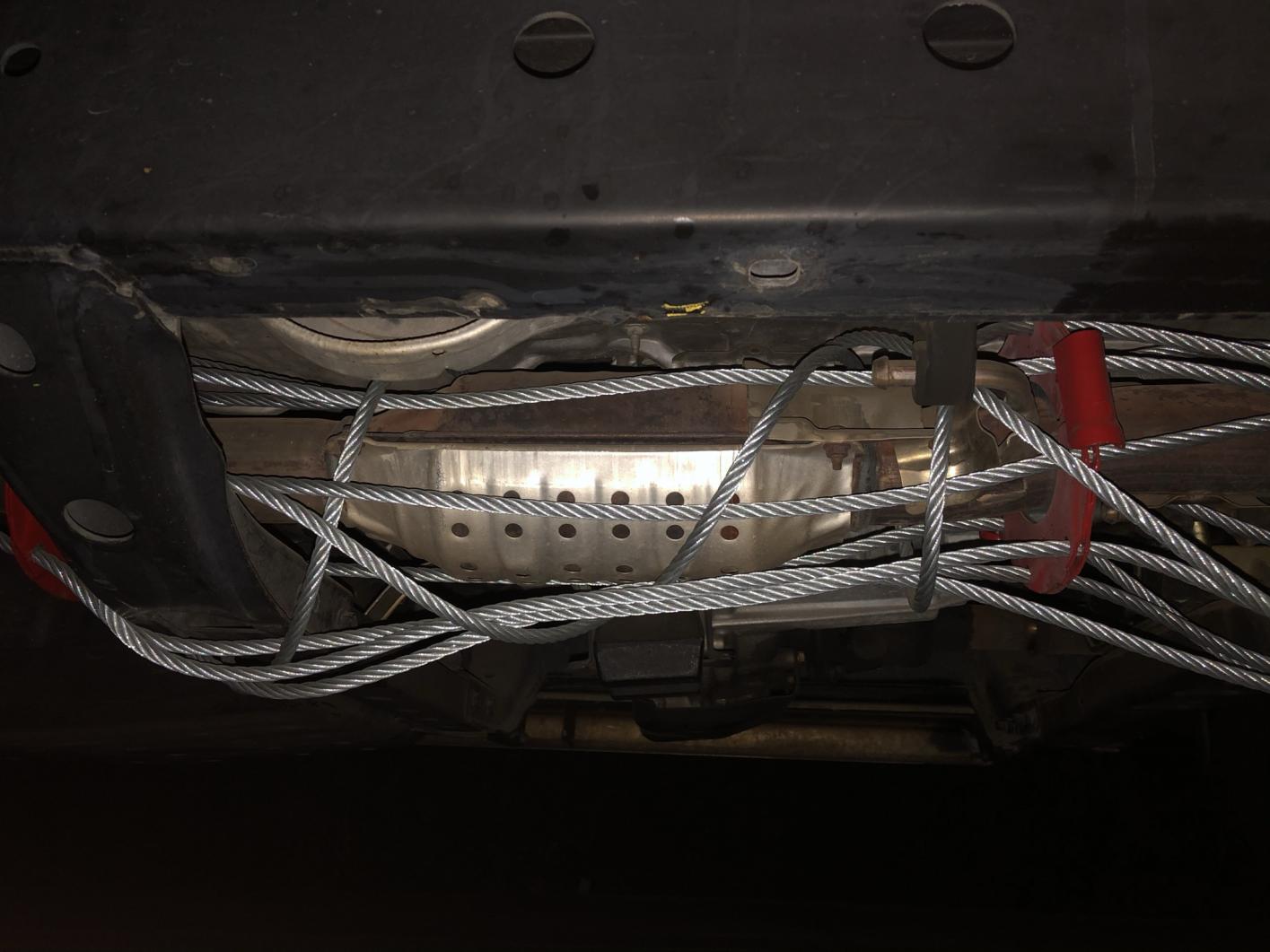

I’ve yet to be a victim, but as a precaution and piece of mind, I installed a CatClamp on mine last year. I’m very satisfied with it’s design, but not sure I would be as satisfied if my OEM running boards were removed. Though I installed the cables as tight and tucked up as best I could get them, the cables would still be pretty obvious from the side view on a 3rd gen if it wasn’t for the running boards blocking them from view.

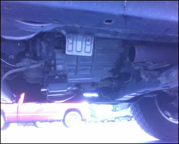

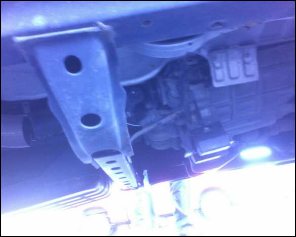

Mine was stolen in 2006 (2001 4Runner). Here's where those cuts were made (sorry about the flip phone pic quality).
At that time, insurance covered this (minus deductible), so I got the exhaust replaced at the dealership with a lifetime warranty for about $1600. Because of where the cuts were made, they had to replace about all of it. I actually got it replaced again due to rust in 2015, covered 100% by that warranty.

Any cat kuffs/clamps would be as easy to cut as the pipe since they have a sawzall, but I doubt they would have a socket set, could even use odd socket cap or torque head metric bolts
It would be very difficult to cut the cables on a CatClamp with a sawzall. It could probably be done with a good amount of time and blades, but the design of the clamp is to greatly slow the cat removal process, thus making the thief move on to much easier targets.

Agreed, I carry an array of 18V Makita Tools with me for work and trail repairs, between the zip cut for the cable which would cut it in seconds and a sawzall and maybe bolt cutters I guess anything can be cut off in minutes including the bolt heads of a steel guard, mind you the sparks from a grinder might attract unwanted attention for thieves. I think not being able to see and easily access the cat would be more of a deterrent than a cable, even if that cable was 1/2" thick I would zip through it in less than a minute.
You wouldn’t be cutting through just one cable. You would need to cut through multiple cables. The cable weaves in and out from end to end of the clamp and the frame rails before the ends are clamped. It took me over an hour just to install it because of all the cable weaving back and forth from end to end. It would probably take me another 1/2 hr to remove it if I chose too. Again, it can be removed, but it would require a lot of cutting, and way more time and work (and noise) than a thief would want to invest.

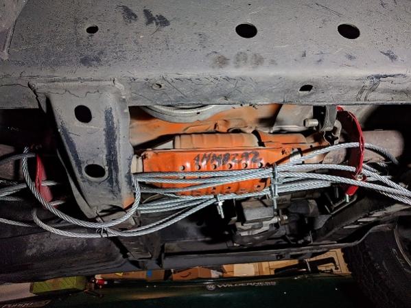

I think some of you guys are missing the point of deterrents such as a CatClamp. A cat thief’s success is based on removing your cat in seconds, not minutes or hours. Instead of being cut and removed in seconds, my cat would be a time consuming and possibly noisy project for a thief. Again, can it be done? Yes! But it doesn’t make sense for a thief to work on taking mine, when there are thousands of other fish in the sea, or rather in the neighborhood that he could move on to!
I also wrapped the cables around the cat to prevent openings between the cables for the cat to possibly slip through. Another advantage is that the cat is still in the open air for cooling. I personally would be very hesitant to put a skid plate (unless it was a heavy screen) under it and hinder ventilation to it.
BTW, each section of cable is clamped at each end. Every hole that the cable passes through is clamped. You can’t just cut one section of cable and unravel the rest. I’ve never used cable cutters, so I don’t know how difficult it would be to cut these cables with them. But how many cat thieves are going to be carrying cable cutters with them anyway? I know that the $350 CatClamp comes with stainless cable if that’s a big concern.
