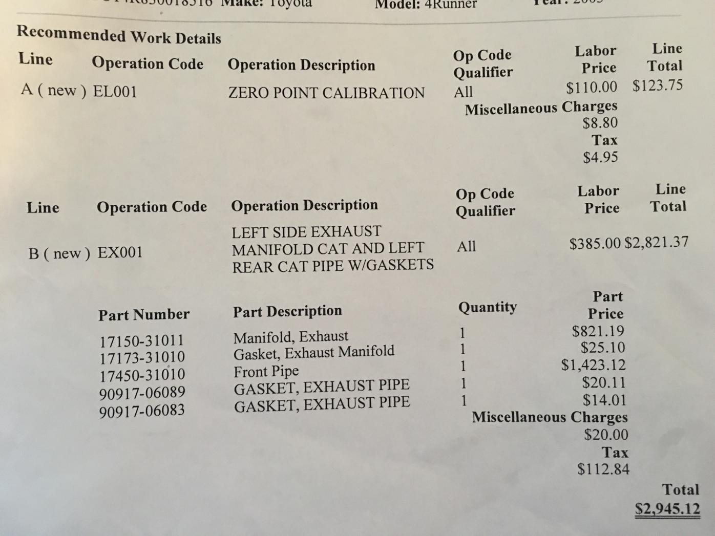

the quote from the stealership was $2,945. it included more then just the cat.... i will attach a picture of the detailed estimate below. do all these parts really need to get replaced?
and keep in mind that i may be moving to california so whatever my solution is it needs to be 50 state legal.

so i decided to call up a local exhaust shop and have them cut off the old cat and weld in a universal to save money. he suggested i do both sides so they are running at the same efficiency. i took his suggestion.
he charged me $750 for parts and labor which i felt was pretty reasonably priced. got it back two days ago and its not throwing any codes yet. i have put 100 miles on it so far. when i had cleared the codes after doing O2 censors (and a few other things i thought it might be) the lights came back on within 40 miles of clearing them. so i feel pretty good about making it to 100 with no lights.
anyway it looks like the problem may be fixed and even though there is a ton of information about p0430/p0230 vsc trac vsc off on this forum.... it seems that every case is a little different.
in my case it was not the o2 censors, upstream or down, nor was it an exhaust leak between the headers and the cat, nor was it a dirty MAF.... it was the Cat.... just like the code told me it was.
