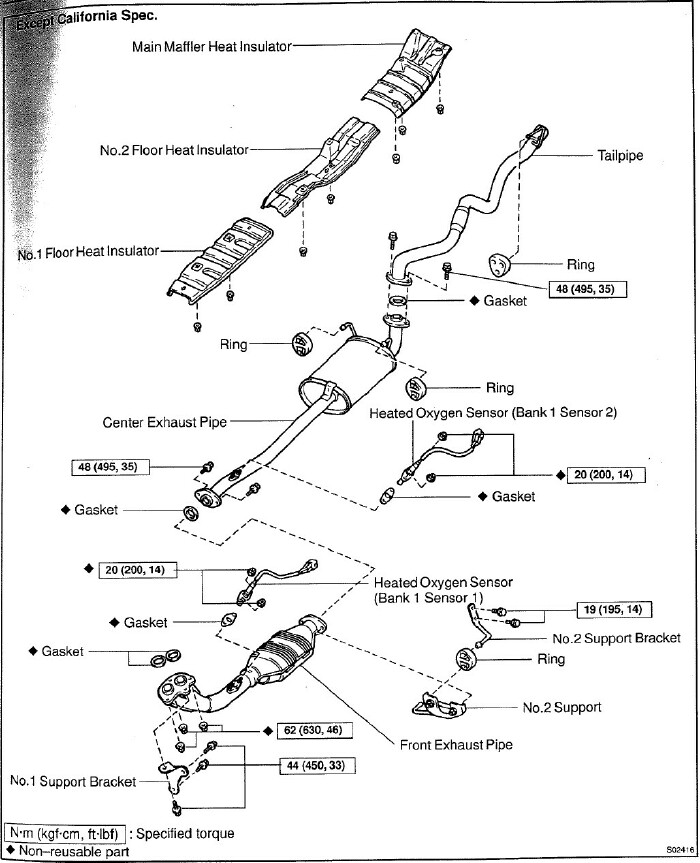

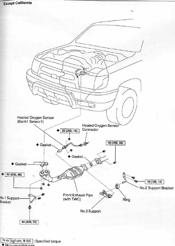

Hey, my buddy just got his cat stolen from his 2000 4runner, and I'm trying to get some info for him. Does anyone have a digram of the whole exhaust system? I'm trying to figure out if we could just put a pipe in for now just so he could drive, but im not sure if the 02 sensors were also taken.
Does your friend have a 49 states emissions system or a California emissions system?
I can give you diagrams, but the two setups are different.

It was purchased new here in chicago, so I'm assuming it it 49 states emission system.

Probably is, but mine came off a lot in Pennsylvania and is Cal spec. Sometimes the dealers take whatever comes off the ship....
I'll get you the pic tomorrow.
hope this helps
