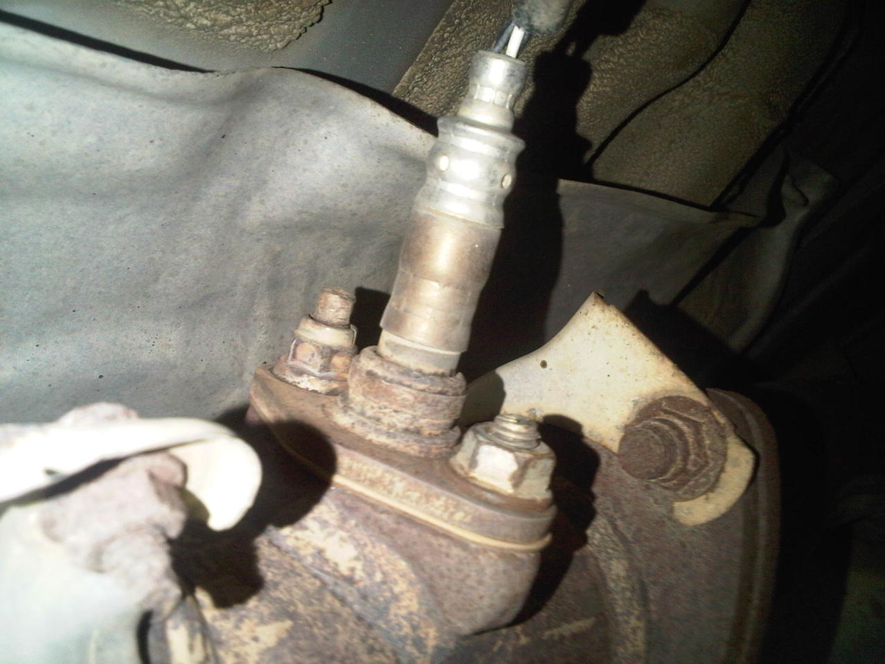

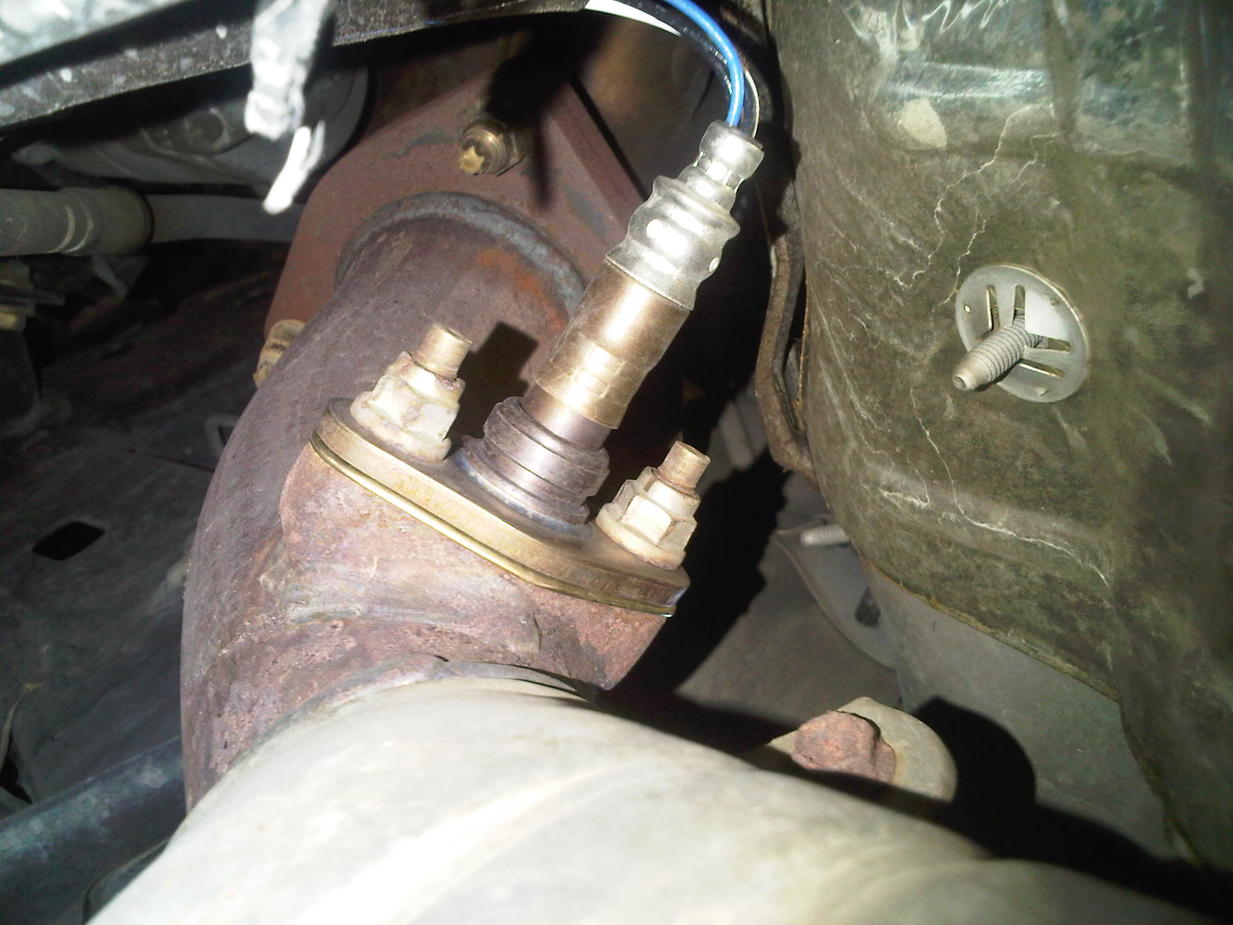

UPDATE:
After inspecting the O2 sensors, I've determined that the rear O2 sensor seems to be old(er) and probably in need of replacement. The first pic is the one before the cat and the 2nd pic is the one after the cat.
So based on the numerous threads I've read, I think it looks old enough that perhaps it is the O2 sensor instead of the cats (wishful thinking).
So question for the expert panel is: does this O2 sensor look like it needs to be replaced?
If so, is this the Denso you would pick for a V6 2000 2WD 4Runner SR5? 2000*Toyota*4 Runner*Oxygen Sensor from Car Parts Warehouse | Add to Cart

The multi-meter test can tell you it is bad, but it can pass that test and still throw a P0420. It does look old enough (considering it's in Texas, that could be one winter old in Massachusetts) that I would change it before I spent money on cats. The link is definitely to the wrong sensors; those are for the 4-cylinder engine. Go here Oxygen / AFR Sensors - Underdog Racing Development to get the right Denso part number, then Google that number and look for the best deal (usually Amazon). Stick with Denso (OEM) sensors.
