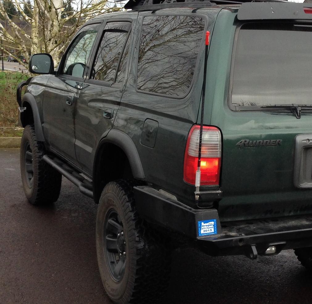

I'm no radio expert but fwiw I run a 2' well below the roof line and it does just fine for off-road trail use. Picks up wx channels fine in the city. I can tell that the long range suffers but I don't care about that. I had a 4' but got tired of hitting my garage header every day.
