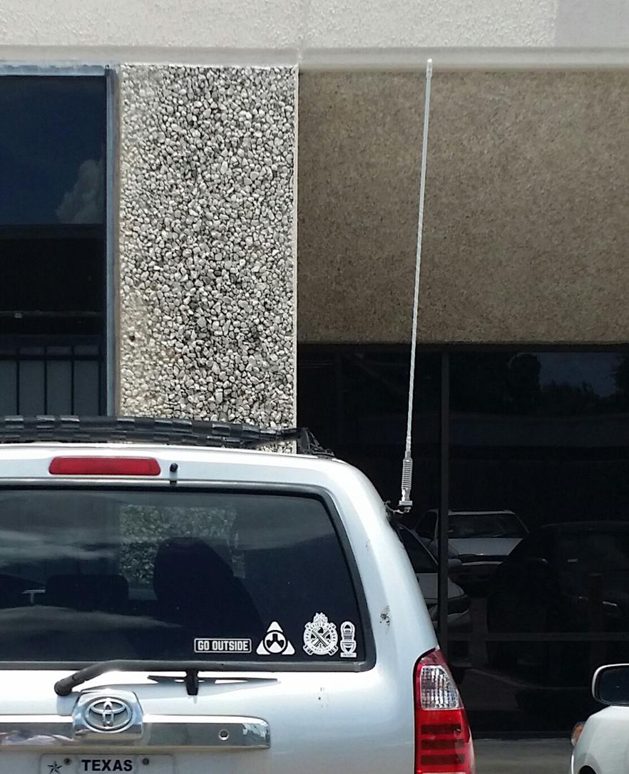

Ok, CB and radio noob here. Please bear with me. During my first Lone Star Jamboree this year, I noticed how crappily my handheld walkie was working out for trail communications, so I bumped a CB install higher up my list. A friend bought me a Cobra unit for my birthday in May, and I ended up purchasing a Comet RS-840 lip mount to go along with the 3 foot fiberglass whip I received from a truck driver I know.
The mount came with 16' 6" of coax, which was *just* enough for a clean install on the side of the passenger footwell. The mount I stuck high on the lift gate, to where a good 2 feet of the whip sticks out above the line of the roof and stock roof rack. Additionally, I added an HD firestik spring to releive some of the stresses from our 85mph speed limits. :tongue: I purchased an SWR meter, and ran some tests. I'm getting a range of values across all 40 channels of 1.4-1 to 1.7-1, which looking a little deeper indicates my antenna is too short. I looked at the whip, and it's not a tunable firestik, it's a 'cheapy' truck stop Road Pro whip.... Which brings me to my questions:
Is it possible that getting a better, tunable whip of the same size would be enough to drop my SWR to more acceptable levels? I don't want to go higher, the spring is already slightly deformed by the wind.

EdmundGTP- I agree they're on the high side. The mount didn't come with its own grounding strap, but I got out my dremel and cleaned the paint off the set screws for the lip mount, and cleaned off the areas where the set screws hit my paint on the inside of the door. Everything else has pretty secure grounds, as checked with my V/OM. (See attached pic for my mounting location) For some weird reason instead of 18 feet of coax, my mount came from the Antenna Shack from 16 feet 6 inches. To save myself a little trouble, I think I'll go with your suggestion and buy a tunable tip antenna and see what I came come up with while fiddling with that. I'll also see what else the tech docs say-- Appreciate that.

Another interesting tidbit: On my way home, I got a radio check back from a guy who called out his closest cross streets. I remembered where I was during my drive home when he hit me back, and checked it out on Google Earth-- He was 5.5 miles away, with hundreds (if not thousands) of office buildings, houses, and cars in the way. Not too horrible! I don't know how well (distance wise) that it will perform while out in the sticks but I'm somewhat reassured.
